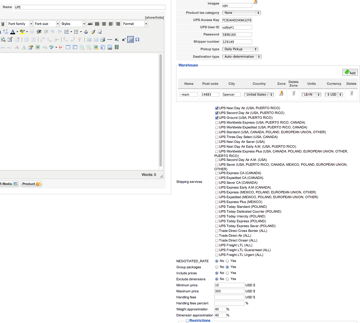

Just configured the UPS plugin for shipping. It seems to work with 1 of each item, and several items - one of each. If you add more than 1 of an item (2), I get No Shipping Method Found. Any ideas?

It come maybe from the configuration of UPS, have you set restrictions ?
Can you give us a screenshot of your UPS configuration ?

11 years 10 months ago #99985
Here is the screenshot. I was able to get the shipping to show up, but it does not add the shipping amount to the order when you go to payment processor.

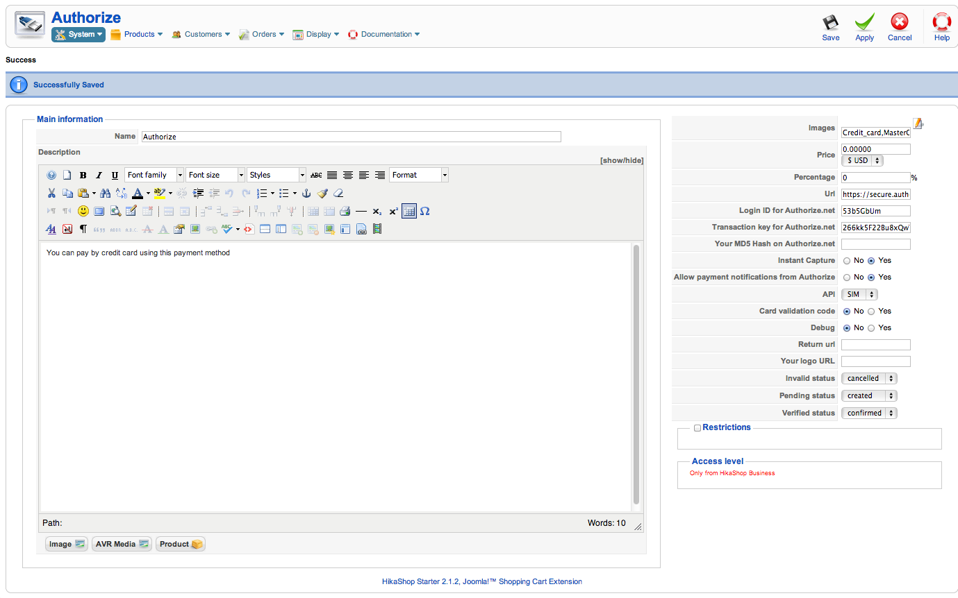

What payment processor are you using and what configuration did you set in the payment plugin ?

11 years 10 months ago #100005
Using Authorize.net. That has been working well for 2 years. We used to use the manual shipping method, I but I upgraded Hikashop on Wednesday to include the UPS shipping method.
It appears that it now working as well. As I add 2 items of the same sku to the cart, the shipping amount is being added. I will check all items now.
