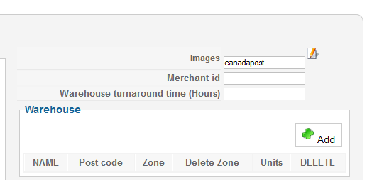

Thanks for that...
here is an example... in the attached file for the Canada post shipping options there is no zone selection at the top of the options... however www.hikashop.com/en/support/documentatio...canadapost-form.html indicates that it should be there...
there are several other areas that have missing options in the software that are or aren't in the documentation. These missing or relocated options are making the setup and configuration more difficult than it should be. Otherwise the documentation is very good.

11 years 10 months ago #100138
All restrictions option (like zone) have been move to the "Restrictions" part at the bottom.
You can check the Restriction checkbox to display the restriction options.
When a configuration have a restriction set, the checkbox would be automatically checked and the restrictions would be displayed.
We added (and we would add) new restrictions so the configuration screen become a little bit complicated.
We move theses options in a specific part to let the configuration as easier as possible.
