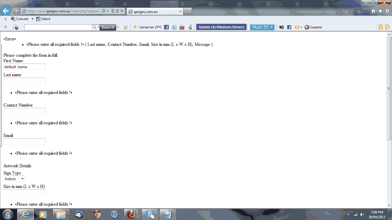

I did activate the debug mode in joomla both debug system and language, set error reporting to maximum and tried again.
Same error. Screenshot provided of what IE, chrome and safari all show when click "add to cart" on product page.

Sure, I've been able to see what the problem is and as you said it's working for Firefox but not for Chrome. I think that the problem is coming from one of your extension called "aiContactSafe", can you disable this extension and try it again ?

The problem come from aiContactSafe, they are adding data in our POST, so the form is not sent correctly.
You have to contact them, and ask to edit their code to not add data.

The problem is generated by the fact that you can't have a HTML form in another HTML form and the form they are using for that "Add to cart" button is taking up almost the entire page. So you can't have another form there, no matter what extension it is used.
You need to modify the way that button is implement so each section of the page uses it's own form.
I should say that aiContactSafe doesn't generate a form on the entire HTML page just to have a simple button, so they will have to rewrite their code to have the form only around the button, not on the entire page.
This sounds logical to me but as mentioned I'm not a programmer, I am having to trust your advise and theirs.
