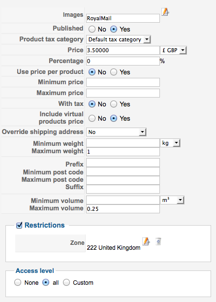

Have created a store with UK Tax (VAT) at 20% and this is the default tax category, I have set up a shipping method (see screen shot) both the shipping method and the product use the Default Tax Category and in the check out the VAT is calculated correctly BUT when you go to the Google Checkout page the Shipping total has increased by the VAT amount and the total updated accordingly.

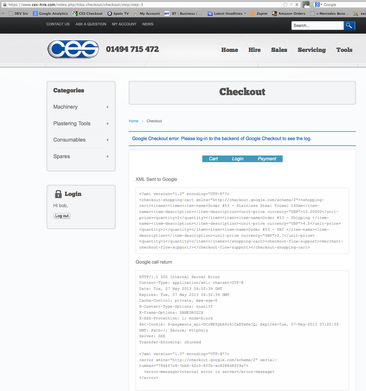

Can you activate the debug mode in Google checkout in order to see the XML content sent to Google ?
Thanks,
  • Posts: 75
12 years 10 months ago #102605
Screen shot of Google XML - looks like the Shipping total is being set with VAT.
