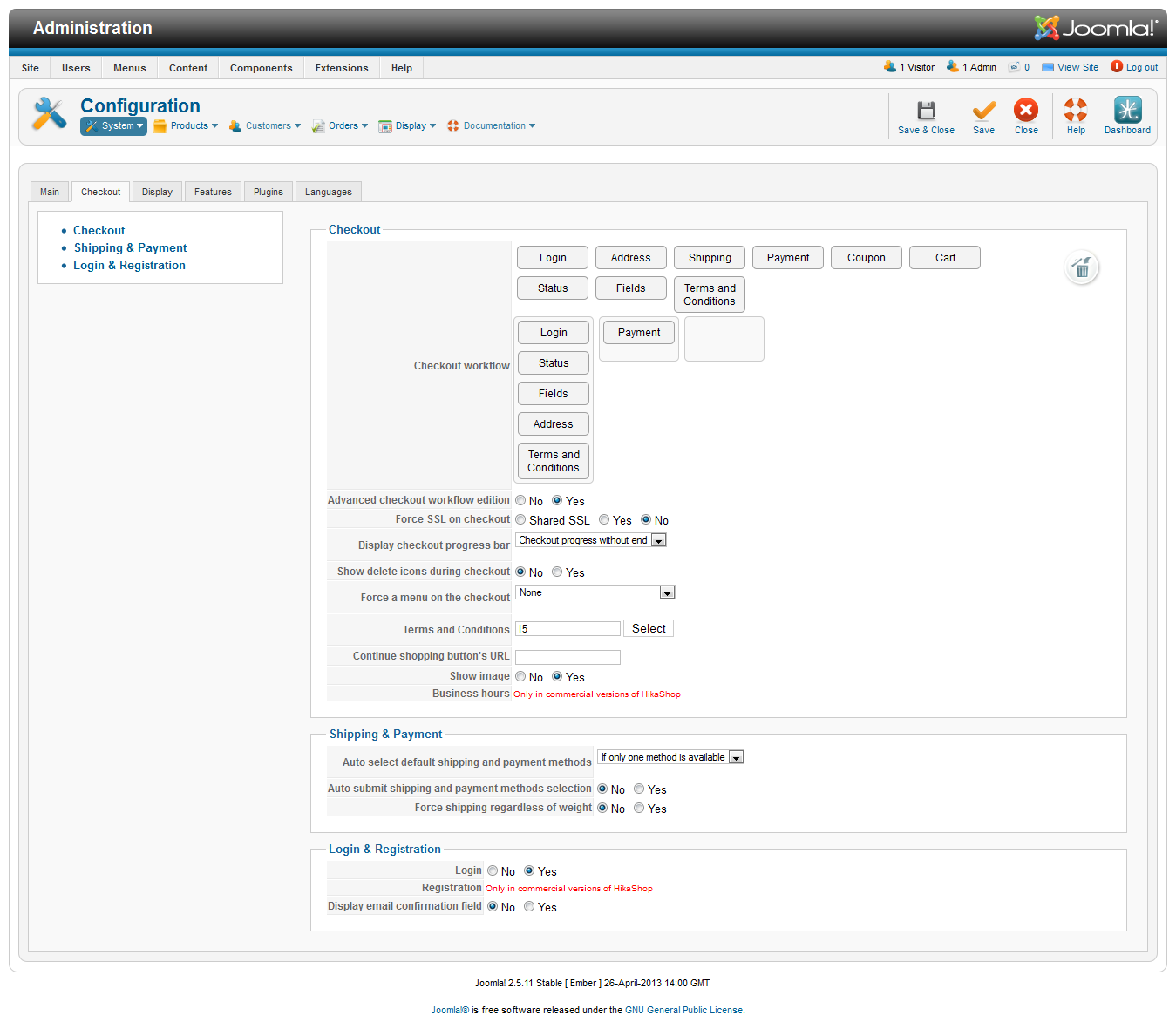

Can you post a screenshot of your checkout workflow configuration ?

in attachment my checkout workflow.

It's normal, the problem is not that there is not enough time to process the page but that there is some code on the page which is looping indefinitely.
There must be some 3rd party plugin interfering here.
I would recommend to deactivate the plugins on your website one by one and testing the checkout each time to see which one is causing the problem, starting with plugins of the group "user" and "system".
