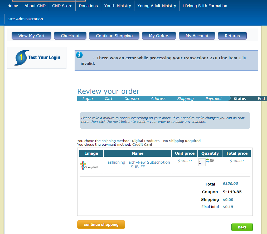

I'm using the latest version of HS (2.1.3) on J2.5.11.
We're using the Authorize.net checkout and when we get to the 'review your order' screen in the checkout process (advanced workflow) we're getting the following error:
There was an error while processing your transaction: 270 Line item 1 is invalid.
And the user is just taken back to that same status page whenever you click the next button.
We also have the check payment (and bank transfer) payment plugin enabled.
We are using UPS and manual shipping methods.
We do require login to checkout.
Can't find anything here that is close to this issue.
Any ideas what might be causing this?
It was working fine prior to a switch to a new server a few days ago.
CORRECTION: When pressing the NEXT button after that error is displayed the user is taken back to the Payment step where they have to fill in their CC info again.
Using the Pay by Check method works fine.

This is an error returned by Authorize.net because the data being passed to it is not valid.
I see that you're testing with an amount of 0.15 dollars. Are you sure that this amount is not too low for authorize.net ?
It could potentially be because of a non ASCII character in the name of your products:

OK ... finally tracked it down (for anyone else having this issue).
It WAS related to what non-printable ascii codes in the title HOWEVER, Authorize.net (or the HS auth.net payment plugin) somehow interprets " - " (i.e. <space><hyphen><space>) as a non-ascii sequence and that is what was blocking the processing.
I'm not sure exactly how this was working before. But after replacing a couple m-dashes with hyphens and then making sure the spaces around all hyphens were removed, it seems to be working properly.
