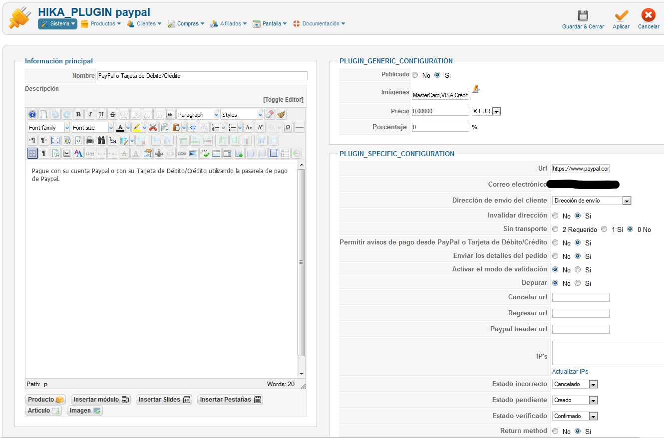

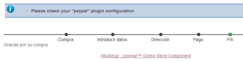

Hello, since I upgraded to version 2.2.0 of HikaShop Business, when I order and I will pay with Paypal, I get an error message:
Attached two screenshots of how I have configured Paypal plugin and the error that appears in the process.
With the previous version of HikaShop worked well. Thank you.

I installed in your website the latest version of HikaShop 2.2.0 which contains a fix for the "no shipping" option.
It should work better now.
Thanks for the report.
