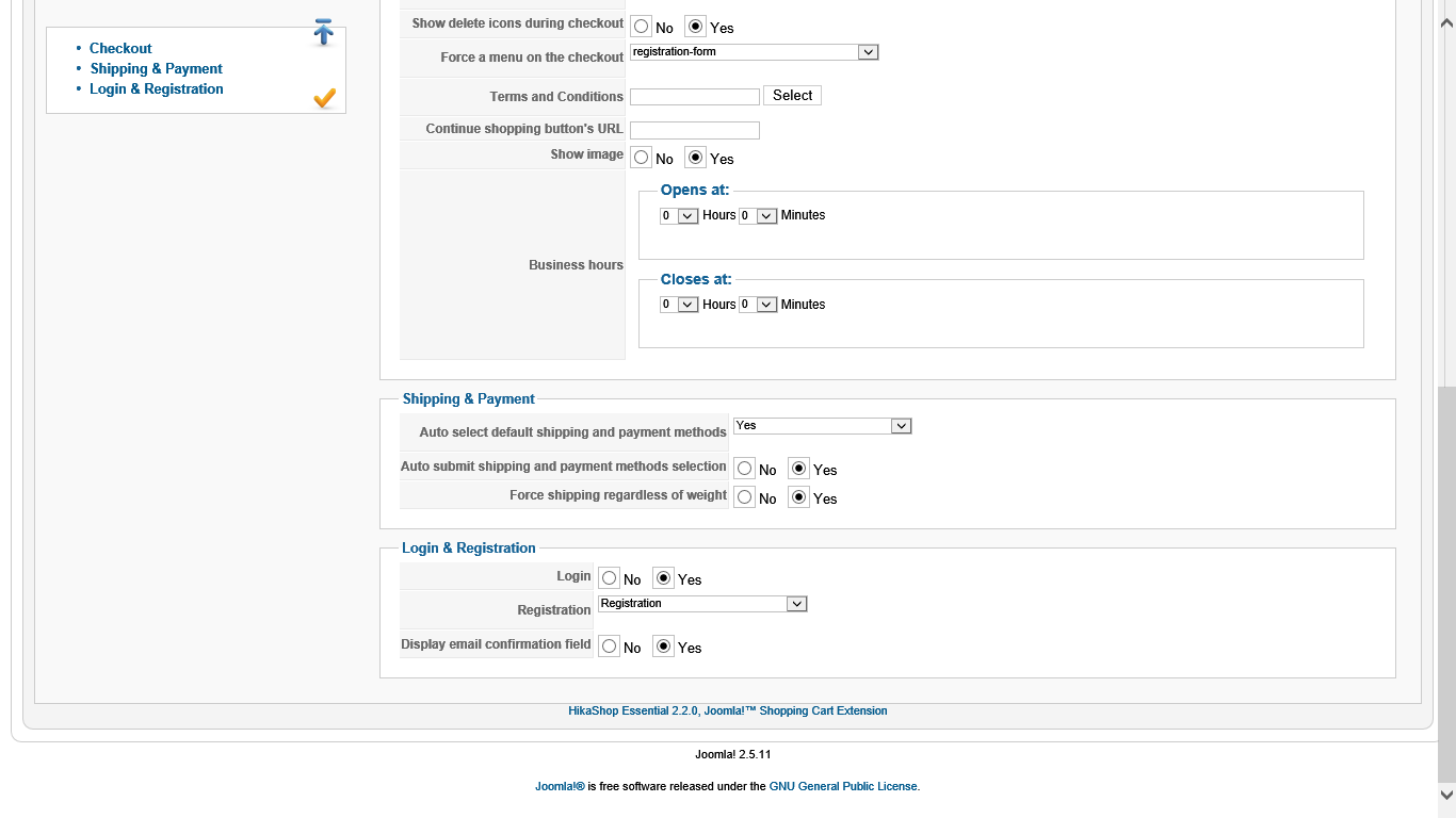

Ok. The website wasn't fully up yet, but i put it online so you could take a look at it. is the url, but the problem with registration is with cart/checkout. Here is the screenshot. Ummm, sorry. I have Windows XP and don't know how to do the screenshot.

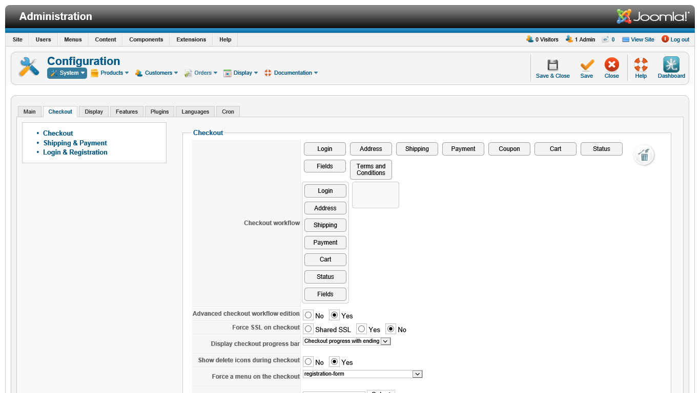

Sorry it took so long. I had some internet issues. :unsure: :unsure: Anyway, here are the snapshots. After you told me, it was like Duh!! This is my first website, so please understand if i seem a bit illiterate when it comes to them. Hmmm, i don't know. I forced a menu on checkout. Regristration menu, which didn't pop up. I don't think i changed any of the custom fields. If you would like, I can give you a login and password to the website administrator, so that you can see it for yourself.

From what I can see your HikaShop settings are fine. Can you make sure that you didn't disable the registration in the Joomla user manager's options ?
