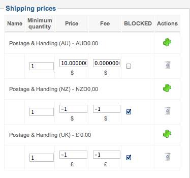

Each item has its own shipping cost - see image uploaded

You should also post here the configuration of your shipping method (a screenshot will be perfect) which could help us spot the issue.
