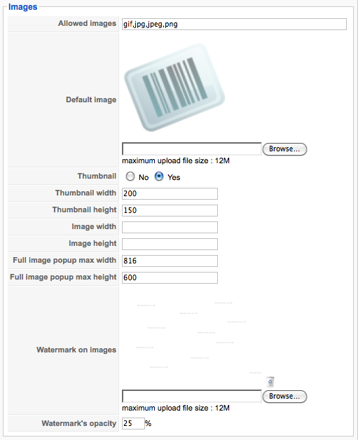

I've added a watermark (png with transparency) to the main config / files and set the opacity at 25%.
The image size is the same as the larger image, the same as the popup from product page.
At present none of the existing images on the site show this watermasrk.

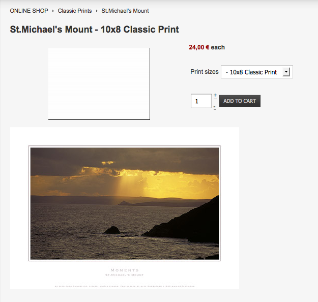

I then tried deleting the uploaded file (used in the popup) and added it again from the local source. It then only showed the default icon. I tried again this time deleting from within the products back-end page and now I have a white image with drop shadow (hard edge).
I have tried deleting cache of thumbs and preview and thumbnails in com_hikashop but still the correct image does not appear.
Are there other files on the server that need deleting before uploading the images again? Or perhaps I have messed up my work-flow.

Opened product page, deleted the image, and selected a new image, but now the image is white without the drop shadow.
