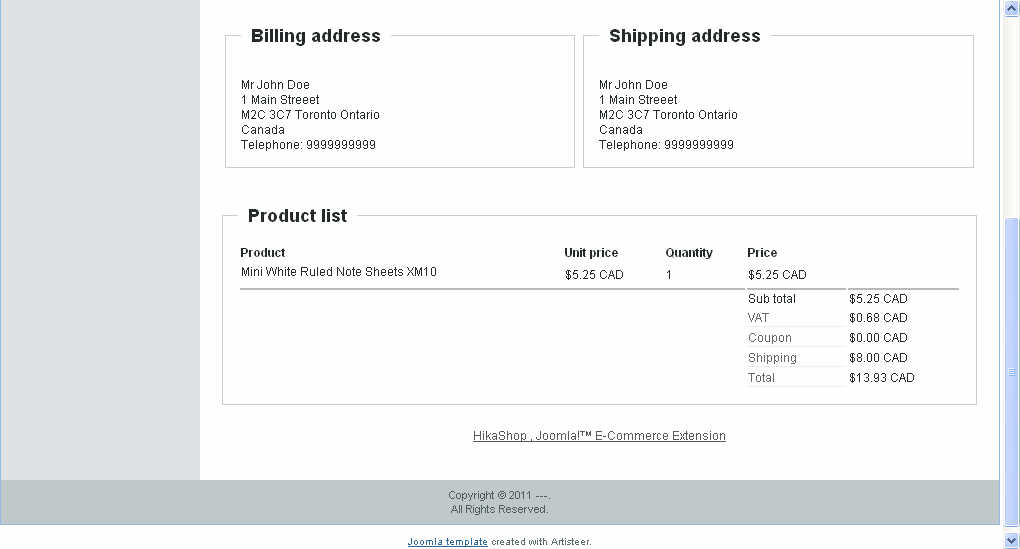

I recently upgraded from free to Essential. Prior to the upgrade, on check out, I had shipping showing the amount including taxes with an explanation in brackets and a tax total showing and included as a line item in the total cost of the order. It now just shows the prices without taxes and the shipping cost is not taxed at all even though it is set up as taxable.
The invoice is correct (except for the shipping tax) but the order displayed is not.

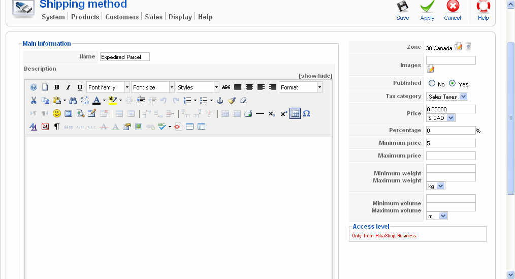

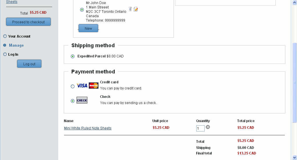

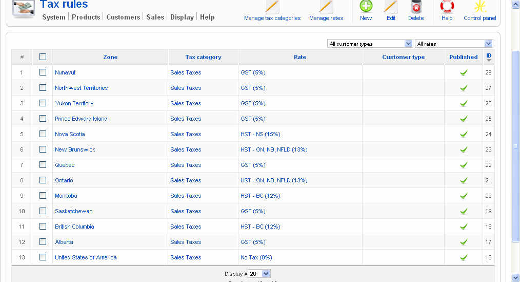

Could you do a screenshot of your tax rules listing, of your main configuration tab , of the checkout with the address of the user displayed and of the product settings ? That would help us tell you what you're missing.
  • Posts: 8
13 years 10 months ago #12253
Here you are:
Hope this works and is what you are looking for.
Last edit: 13 years 10 months ago by Donna.
