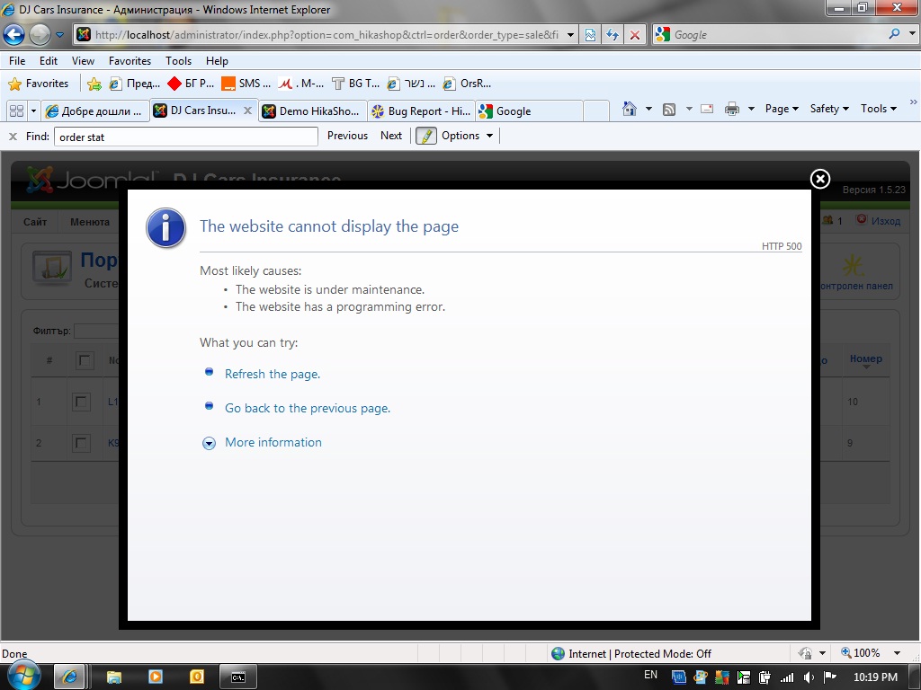

Hi there
I receive error 500 when changing order stauts
The mail system is configured propertly and i sending mails correctly.
The joomla version is 1.5 and the HikaShop 1.4.9 OS win 7 iis 7.5

  • Posts: 3
13 years 9 months ago #14959
Hi Nicolas
The issue resolved.
PHP ini file was configured with:
log_errors = On
error_log value on the php.ini was without path means that php will write erors on php system wariable path (in my case c:\php)
So i changed to
error_log = "c:\php\some_text_error.txt"
I tried to change the order status and is working perfectly
I don't know if the change of the php.ini values is the reason.
I attached also the php_error log for your review but like i said now is working perfectly.
Best regards and tnx

13 years 9 months ago #14963
Thank you for getting back to us on that error.
The problem comes from the fact that some variables are missing on the text version generation code of the status notification email. Thus, PHP want to write these messages in the log of your php but since your log files weren't configured properly it couldn't and you had that 500 error.
We'll fix the variables for next release.
