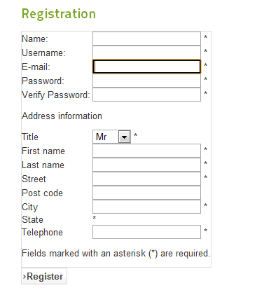

Was testing the site and realized there are no states for the US in the registration process on this site. Haven't had a problem with that before. tried to enter states, and that didn't work either
any ideas?
thanks
bc

Do you see the address state field line on your address form ?
Do you have a javascript error on that page ? When you have a javascript error (in HikaShop or in any other parts of your website), the state dropdown can't be loaded dynamically by HikaShop.

it says STATE then * nothing else no input box shows
other countries have states listed, but not US? how would i find the error?

The problem comes from your template which uses jquery without calling the noConflict function as explained there:
stackoverflow.com/questions/833883/weird...type-jquery-conflict
So it breaks the javascript on the page and thus the HikaShop javascript cannot be run properly.
You need to add that jQuery.noConflict(); code in your template's javascript after loading the jquery library in order to avoid any conflict with the joomla mootools javascript library.

Looking deeper into it, I can see that the jquery.js file of your template already has the noConflict call so it seems to come from something else. I also see that you have the error everywhere on your website:
Uncaught ReferenceError: jQuery is not defined
You should ask your template provider about the problem. It's your template's problem and we are not specialists in that field... Let us know what he tells you.
