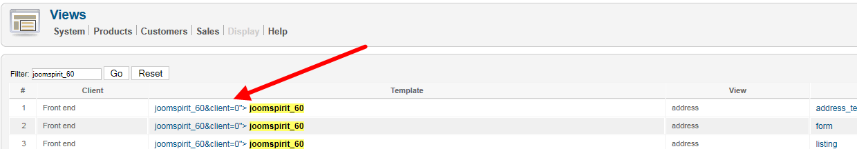

G'Day,
- Hika 1.5.0
- After performing a search filter in views in the back end the <A> tag is incorrect
Last edit: 13 years 11 months ago by TheEdge.

Thanks for the bug report
You need you edit the file "listing" of the view "view" via the menu Display->Views for your back template and change the lines:
<a href="<?php echo JRoute::_('index.php?option=com_templates&task=edit&cid[]='.$row->template.'&client='.$row->client_id); ?>">
and:
<a href="<?php echo hikashop::completeLink('view&task=edit&id='.$row->id);?>">
to:
<a href="<?php echo JRoute::_('index.php?option=com_templates&task=edit&cid[]='.strip_tags($row->template).'&client='.$row->client_id); ?>">
and:
<a href="<?php echo hikashop::completeLink('view&task=edit&id='.strip_tags($row->id));?>">
And that will fix it.

We'll add that modification to the next release.
