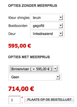

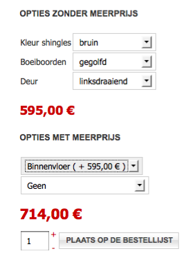

I've added some options to my product.There seems to be something wrong in how the price is displayed in the dropdonw box.
The price of the main product is €595,-. The option will cost €119,- so if the customer will have the option, he will pay a total amount of €714,-.
When I choose the option from the dropdown box it shows '+595,-' so the customer will think the option will cost €595,-.
The total price is displayed correct after selecting the option, but I would rather see that the dropdown box shows '+119,-' instead of '+595,-'
Can this be solved?

There is a bug on that end in current release.
You need to add the code:
$this->row =& $option;
after:
if(empty($option->variants)){
in the file components/com_hikashop/views/product/tmpl/option.php

Yes, that did the trick!
Thanks a lot, it's great to have such quick support! Good work!
