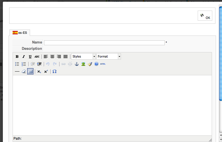

I'm having a very weird issue with adding languages to my product page. I added all the languages and they show up in the tabs, in the admin area. When I click the language and add the content, hit save -- the content doesn't save but it clears completely. See attached image.
Does any one know why it would not save my text?

That's the first time someone is reporting such problem. Does it work in others areas of HikaShop (categories, or characteristics for example ?)
If you go in Joomfish and translate the product from there, does it work ?
Could you also try to activate the debug mode in the config of joomla and try again ? Do you get an error message ?

No, it doen't work in other areas of Hika. The same problem appear to be in translating category as well. I'm running 1.6 and Joomfish is not compatible on this version it seems.
I also have the Business version if that matters at all.
I went ahead and activated the debug mode in Joomla but it didn't make a difference.
Thanks again, I would love to hear more ideas...

Indeed, JoomFish in not compatible with joomla 1.6 yet. So you won't be able to translate your content until joomfish is compatible. I know that they are working on a new version compatible with joomla 1.6 and that they already have something more or less working so it's moving forward... But it seems that it will take a few more months before it's ready...
