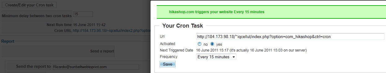

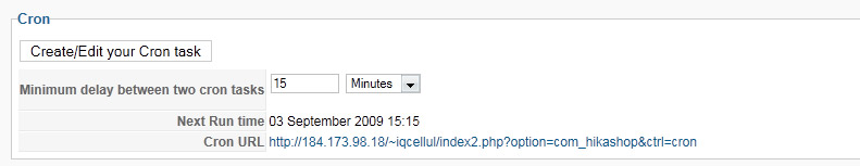

it says the next time it will run is in 2009? and when i click the link it's a 404 not found.. please advice..

You don't have the index2.php file. Did you deleted it ?
You can edit the cron and change the index2.php in the url to index.php and it will work.

i edited it, and it updated the date but the url stayed the same. and no i didn't delete index2.php, idk why it wouldn't be there.

13 years 10 months ago #19041
It should work now.

on the past screenshot i was trying to point out that the corn url still had index2.php even tho i edited the cron job.

Yes I understood. It's just a display issue so don't worry of the index2.php there.

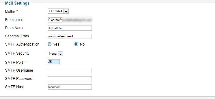

like i said it was working fine before why would it stop working out of nowhere? i have it using the phpmail. check out the settings

Probably because your new server does not handle emails like your previous one... I'm almost sure that the registration emails of joomla do not get sent either on your website.
Maybe your new server requires you to use a SMTP connection to send the emails ? You should ask your hosting company about that problem.
