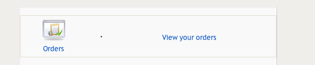

I activated the user account. When I click on "view orders" I get an error :
Fatal error: Class '' not found in /home/content/25/7962825/html/home/libraries/joomla/database/database/mysql.php on line 434
Any ideas?
Thank you.

I don't feel comfortable to do that... is there a different way to maybe just disable the vie orders option for now?
  • Posts: 83603
  • Thank you received: 13533
13 years 10 months ago #19326
You can remove the line:
$buttons[] = array('link'=>hikashop::completeLink('order'.$url_itemid),'level'=>0,'image'=>'order','text'=>JText::_('ORDERS'),'description'=>'<ul><li>'.JText::_('VIEW_ORDERS').'</li></ul>');
in the file components/com_hikashop/views/user/view.html.php
But you will loose your modification when you update so you will have to reapply it.
Last edit: 13 years 10 months ago by nicolas. Reason: wrong file path...
