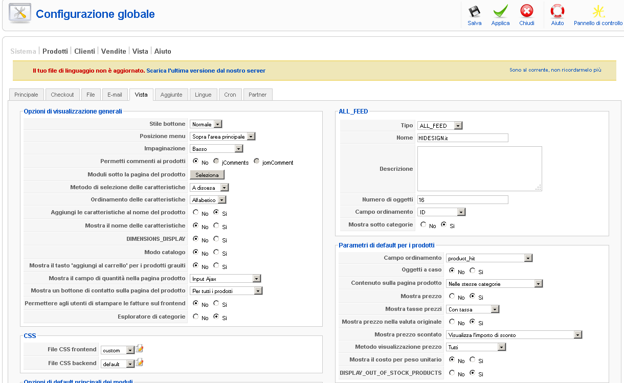

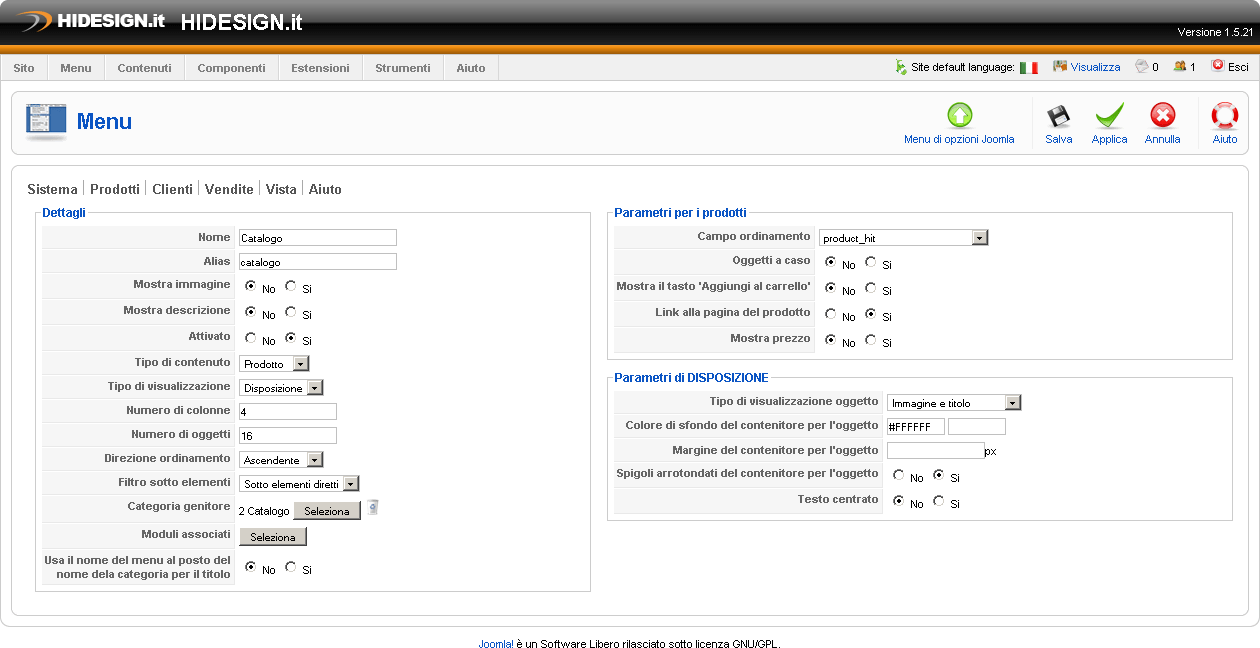

Could you do a screenshot of the hikashop options of your menu ?

this is the screenshots of the hikashop options of your menu and global configuration.
  • Posts: 251
13 years 10 months ago #19695
and this

13 years 10 months ago #19718
The product_hit column was always 0 so far. So setting the ordering column to that in your menu's options won't do anything.
You should choose between the columns product_name or ordering or product_created...
