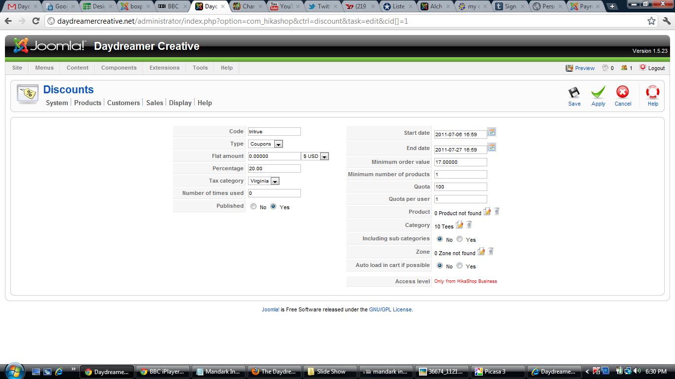

my coupon isn't showing upon checkout what's the deal?

You'll have to give more information if you want us to help you...A screenshot of the coupon options, the version of HikaShop and a link to your website would help us help you.

Indeed. I am using the commercial version 1.5.1 and my site url is www.daydreamercreative.net . Attached is a screenshot.

It seems that you removed the coupon view from the checkout workflow. If you add it again, you should see the input box for coupon codes.
