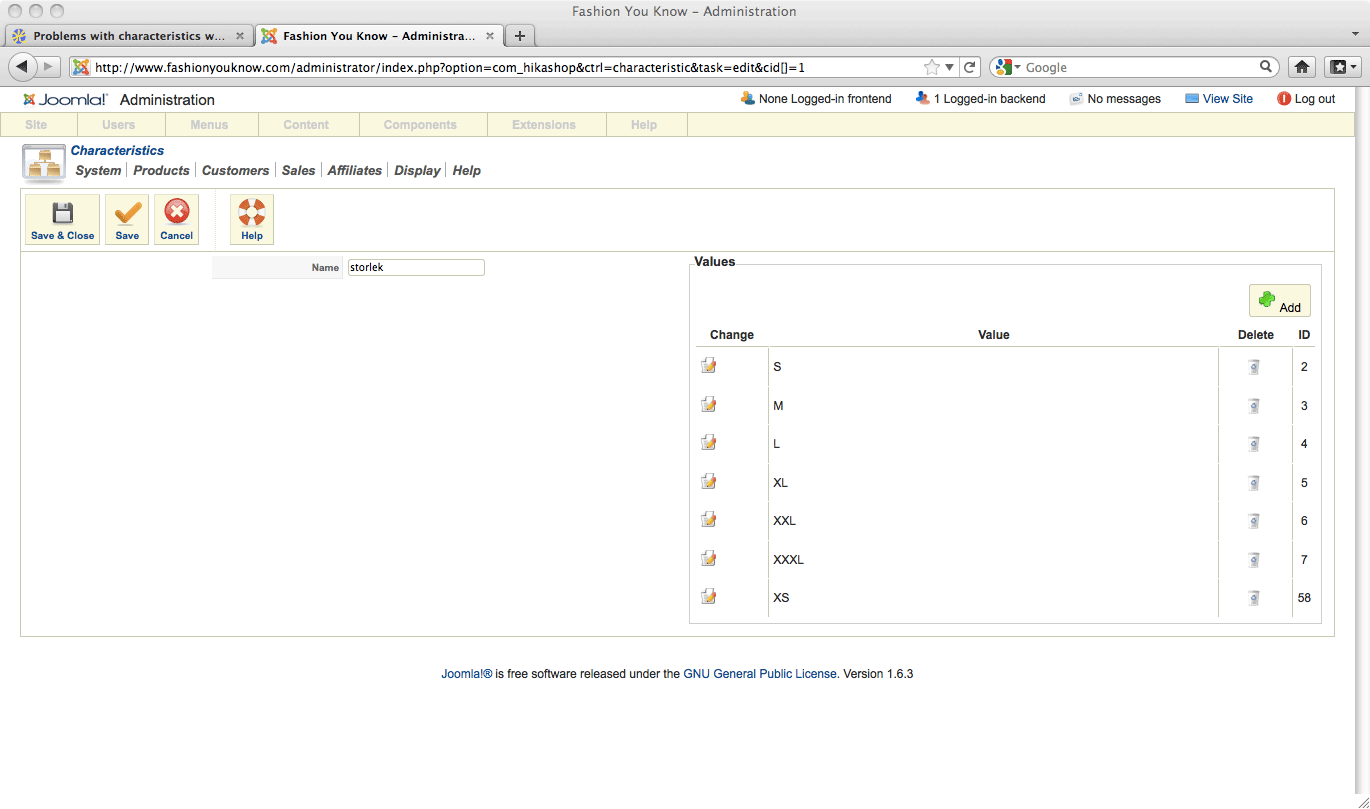

Could you do a screenshot of the characteristic storlek edition screen ?
I see that you use both upper and lower case or the characteristics values... It might come from that...
