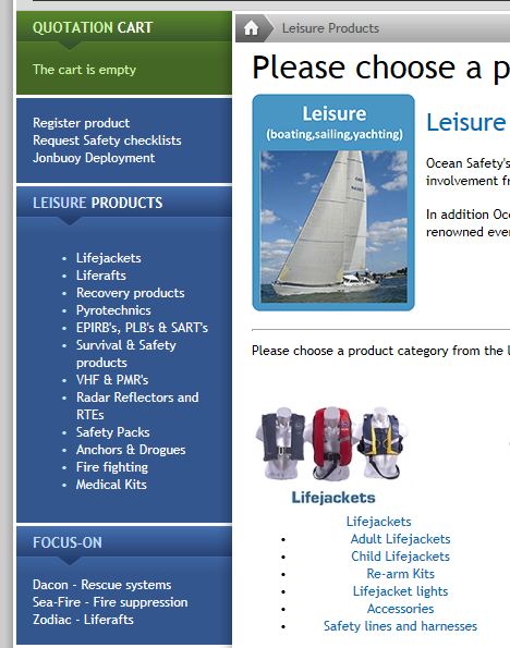

Please see attached image :
My sub categories in the page were all left justified before the update, now they are all centered. I have checked all the modules and they have 'no' selected for centering.

It's not a text-align modification but a margin modification that you need to add in your CSS:
.hikashop_category_listmenu{
margin-left: -30px;

Sorry I pointed out the wrong part, it is not the blue menu I am worried about, it is the category listings on the main content part.
You will see under Lifejackets that Adult lifejacket etc are now all centered. Before you chose the option 'no' in text centre on the module and they aligned to the left, now they dont.

You should try to turn off the "text centered" option of you menu with the id 34. You will find it via the menu Display->Content menus.
The problem is that that option was not working before and we fixed it. Since you have it turned on in the options of your menu, the text is now centered.

Im afraid, as you will see from the message above, I already have it set to no. All my menu modules have this set to no but since update it has reverted to center whatever the option is set to.

Well, you said that you checked your modules, but I'm talking about a menu. Did you check that menu's options ?

SOrry, yes Under Display --> Meus they are all set to no centering.

That's strange...
The CSS code generated is:
#hikashop_category_information_menu_34 div.hikashop_subcontainer {
text-align: center;
which indicates that this option is turned on for the menu 34...
Anyway, a simple way to solve the problem for good is to add the CSS code:
text-align: center !important;

I used text-align : left of course rather than center and all is now good again, thanks for all your help today :)
