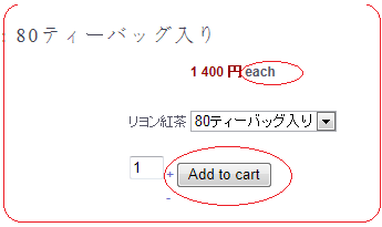

I have Joomla 1.7 RC + Hikashop starter v1.53 and I was kind a stuck with the Japanese translation part.
The "Add to Cart" button still shows in English and all contents example "Total", "quantity" and so on.
Steps done
1) Updated automated JP language within hikashop
Is it a bug on a clean installed Joomla 1.7 + Hikashop ?
Or just something I am missing please anyone assist !
Tomo

There was indeed a problem in the language file. Please update it again and it should work.

I have another problem in language file.
Some words were not displayed as I modified in Japanese language file. Some words were displayed as I changed.
Japanese language file can be modifed and saved in Hikashop. But it shows original in front end.
an exsample;
Original ---> PER_UNIT="単価"
I changed to ---> PER_UNIT=""
It still displays original "単価" in front end.
