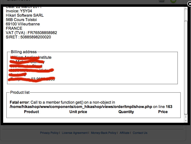

I am using Hikashop Business and it is very important that my customers are able to print a tax invoice from the site but this function does not seen to work. When the print button is clicked from the order page a blank popup appears for a couple of seconds and then vanishes. When the print invoice button is clicked a popup appears but with no values and no button to press to print. I logged into your site to print an invoice of my Hikashop purchase to see how it worked but got this error (see picture). I am using Joomla 1.5.23 with HikaShop 1.5.4. I saw some other threads and downloaded todays version of software and installed it but there is no change,

13 years 6 months ago #28049
The invoice printing problem which was raised previously was in the back end.
You're the first one reporting the problem on the front end actually.
We've fixed the problem and uploaded a new install package which fixes that problem. If you download it again on our website and install it on yours it will work.
Thank you for reporting the problem.
