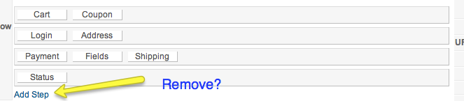

After playing around for a bit, I noticed I had an empty step in my Checkout Workflow. I added a new step ans some processes and it worked fine. The problem was an empty step, but now have a new problem: How do I remove steps? There is an " add step", but no "remove step" How do I do this?

The checkout workflow does not have any influence on the cart.
If you leave a step empty it will be removed automatically. That's why there is no 'remove step'.
If that's not the case, maybe you downloaded one of the first build of the 1.5.4 which had such problem. So you would have to redownload the package from our website and install it over your current version to have it working.
The option just after the checkout workflow enables you to deactivate the interface so that you can directly interact with the workflow as saved in the database so you can also use that to change the workflow and remove an empty step.
