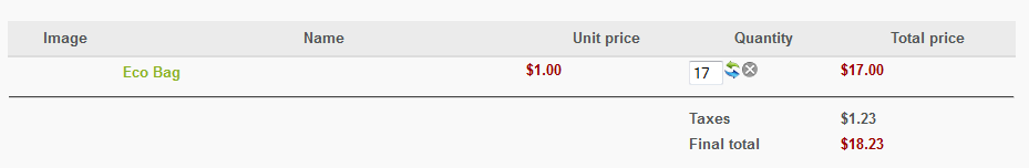

I am attaching a picture of the cart. If you look at the sales tax line, it appears to be per unit. It should show the total tax on the order so all of the fields add up, and of course pass those values to the back end order so that everything is in sync.
Thanks in advance,
Mike

Could you try to turn off the "show detailed taxes" option in the Display tab of the configuration ?
For the Payment plugins, you might have some problems with some of them as the country code might be rejected. You'll have to test that...
The following user(s) said Thank You: Mike2001

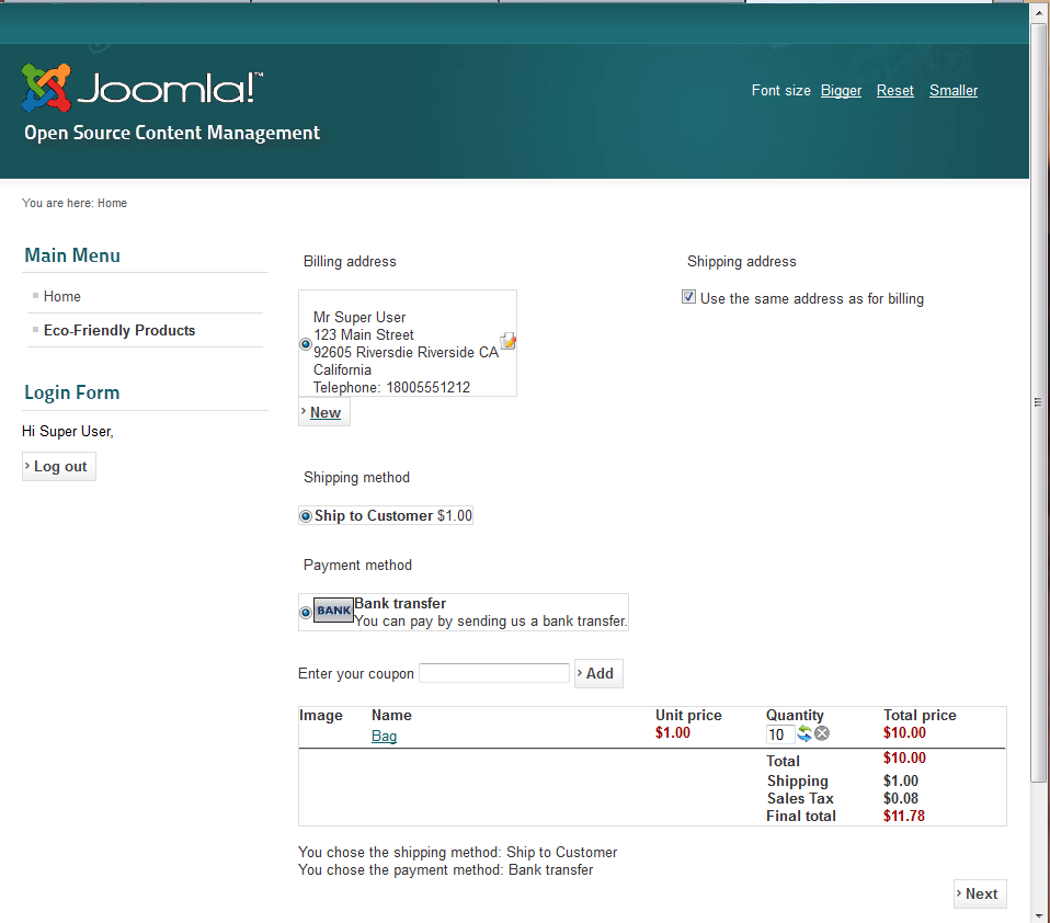

Ok, I noticed the generated order email includes tax at the detail product level and I want to eliminate that. I upgraded to the Business version to accommodate this need.
What is the easiest way to eliminate the detailed tax in the email?
Can I set the system to not display detail product tax on all screens?
Thanks again for all the help...
(the cart currently displays this exactly the way I want the email, see pic below)

There is no global option for taxes.
You will have to edit the emails via the menu System>Emails and change the code:
$item->order_product_price+$item->order_product_tax
by:
and the code:
$item->order_product_total_price
by:
$item->order_product_total_price_no_vat
  • Posts: 28
12 years 10 months ago #43735
Works like a charm, thanks again...
