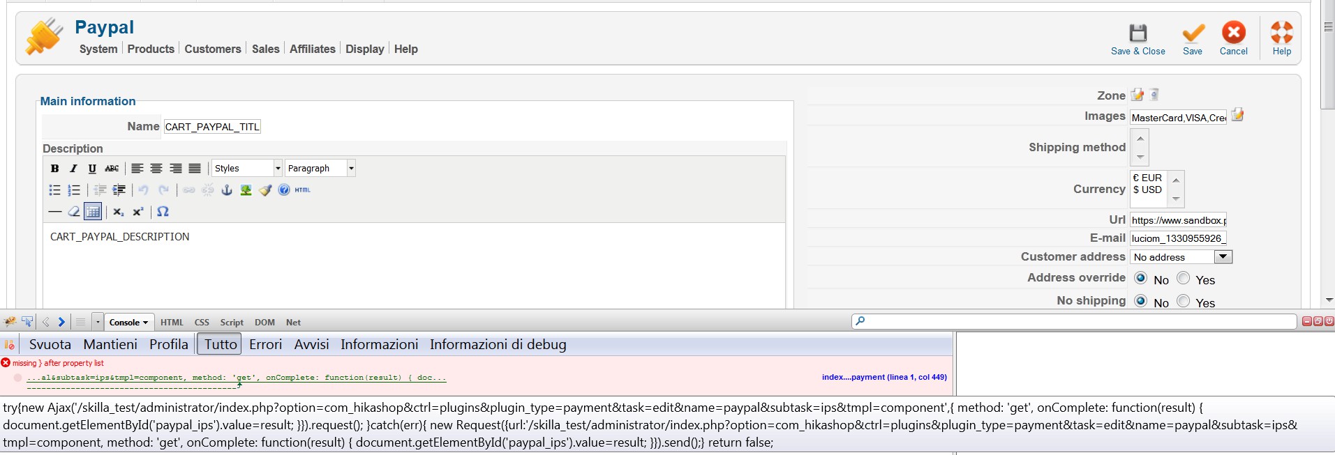

Thinking now I'vent' listed proper sandbox paypal Ip's to get the IPN:
When I try a REFRESH I get the error I've attacched on the screenshot.
I've tryed to list it manually, found the list in here:
ppmts.custhelp.com/app/answers/detail/a_...ZC9XTGtXclVTaw%3D%3D
so I added 173.0.82.* to the list.
disabled the firewall but nothing is happening, even log is still empty... any suggestion?!
Thanks in advance
