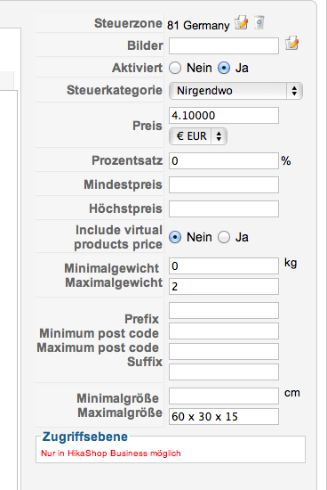

Then please do a screenshot of your shipping method configuration and give a link to your shop so that we can see what you did as it is a configuration issue on your end (it works for everyone else).
  • Posts: 4
13 years 3 months ago #35625
please find the screenshot attached.
