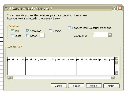

ok thanks for getting back to me - i've tried that but it still won't work. i've attached a pic of what the text import wizard looks like on my end. I've also tried it on my home computer (newer version of excel on it) but it still mixes up the data.

I've opened your CSV on my end with open office calc ( I don't have excel. That's a free equivalent to excel ) and it's displaying fine. So It must be excel not interpreting properly the CSV.
I see that you ticked tab as a delimiter when opening the CSV. You might want to try again with that option unticked. That might help Excel.
