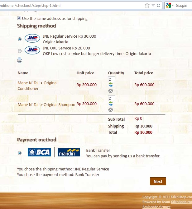

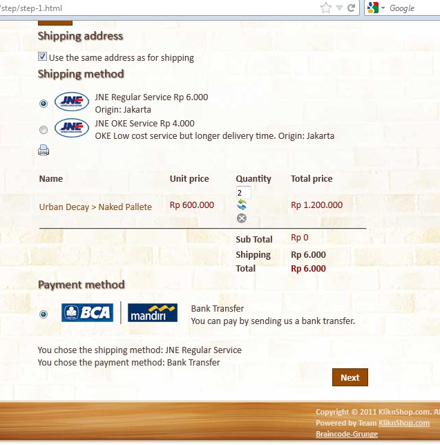

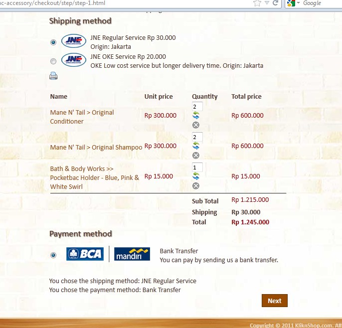

i have used hikashop starter for one year and never found this until just now. This is a case in calculation of invoice in checkout process.
case:
-if products are totaled for 1.200.000, then the calculation for 'sub total' is 0
-if products are totaled for other than 1.200.000, then the calculation for 'sub total' is working fine
-i have tried different products combination to recreate the case, and yes they do recreate the case.
-im not sure whether there is other number that will make 'sub total' to 0
i attached screenshots for better understanding
Any idea how to fix this??

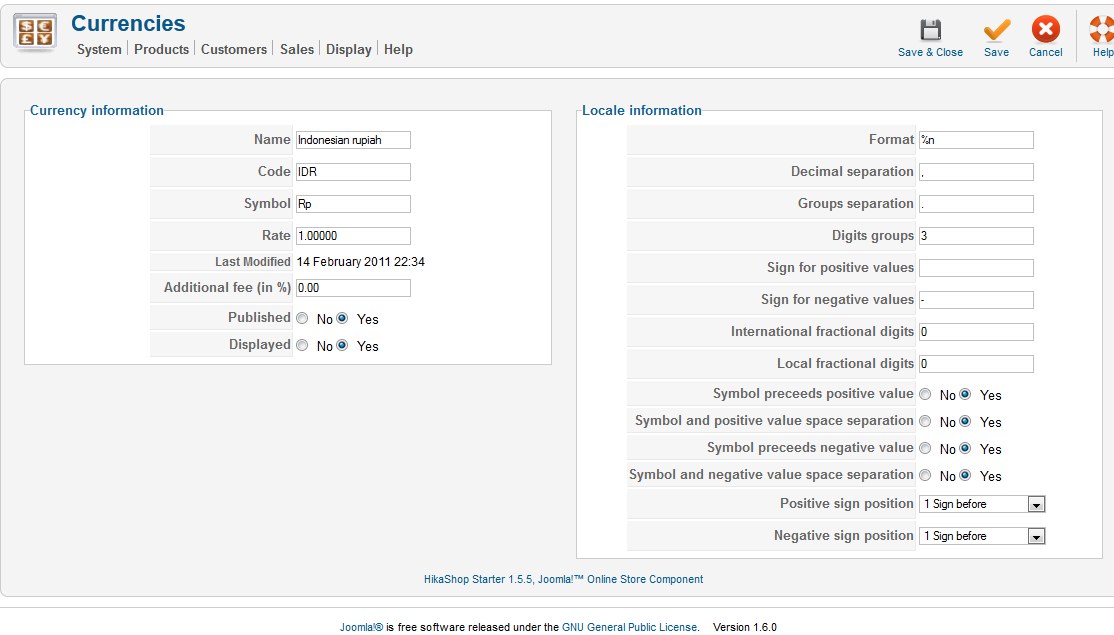

Could you do a screenshot of your currency options editions screen so that we can see how you set up your currency. Maybe it comes from one of the settings there...
  • Posts: 51
13 years 2 months ago #40269
yes, that is why this is a strange behavior, i couldn't produce same case in my local either (eventhough my local is the exact replica using akeeba backup)
I hope this is the screenshot that you after
