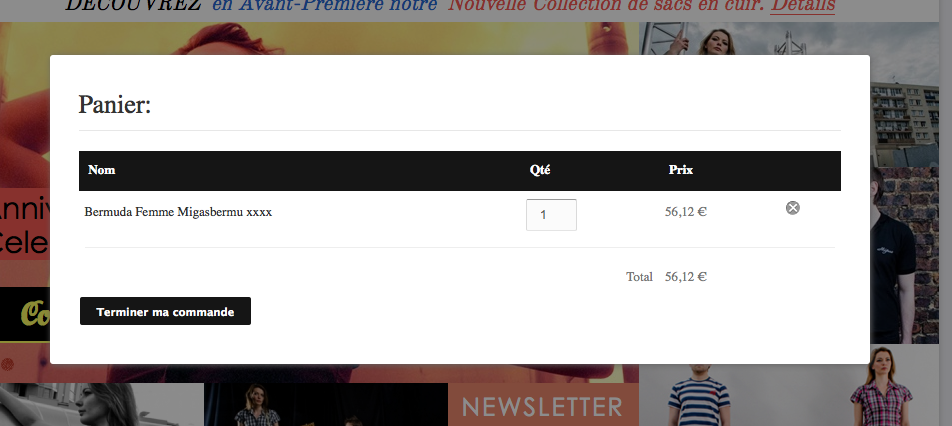

  • Posts: 16
11 years 9 months ago #111589
i turn off the mini cart option and i get only the total, but not the list (attachments). It's normal?
thank you very much

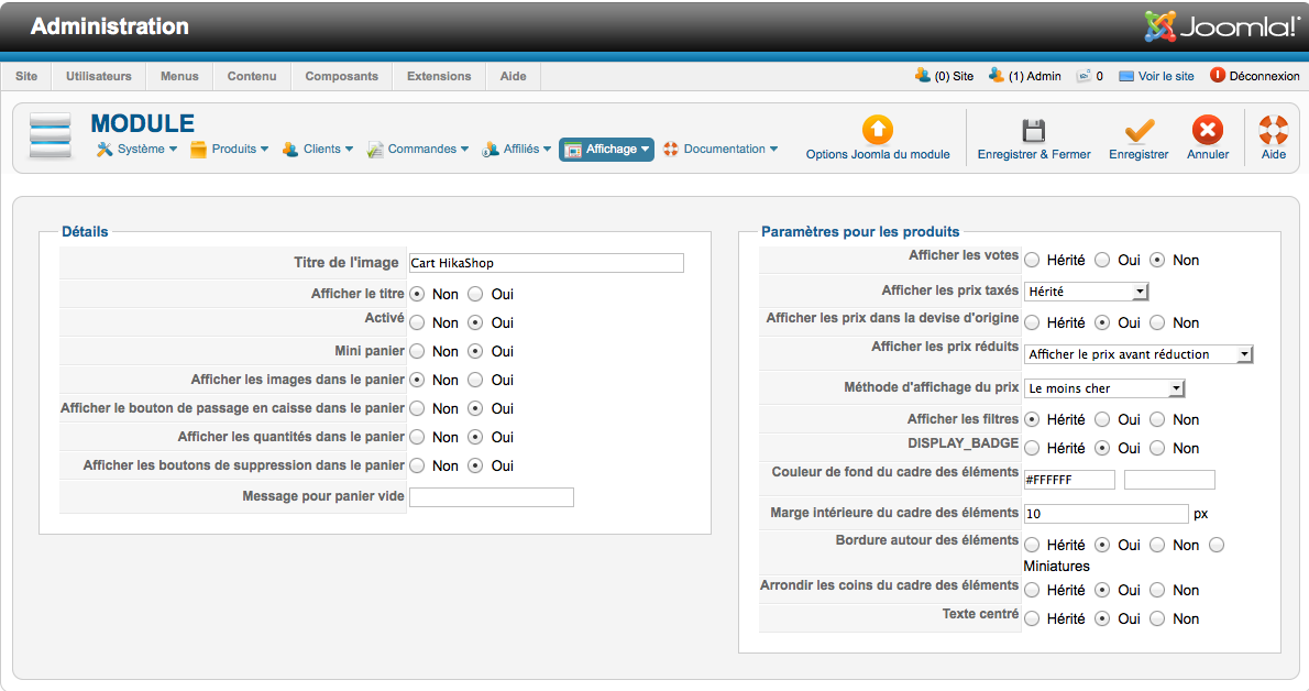

11 years 9 months ago #111595
Can you send me a screenshots of your cart module and of how did you configured your "HikaShop Cart Module" through "Hikashop->Display->Content Module".
Thanks :).
  • Posts: 16
11 years 9 months ago #111600
in attachment.
Thank you.
  • Posts: 2334
  • Thank you received: 403
11 years 9 months ago #111608
I think you forgot the screenshot ;)
  • Posts: 16
11 years 9 months ago #111645
ops :)
11 years 9 months ago #111647
Then can you set the mini panier option to NON and show me a screenshot of your cart module through your shop :) ? if it don't change your cart module, can you give me a link to your shop for testing purpose ?
