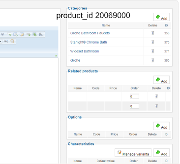

also, here is a shot of how one of the items looks in the admin:

The problem is that your SKU is an integer. So when HikaShop import the related products, it thinks that you're giving him the product id and not the product code. That's why you get the blank line in the related products listing. You should either use product ids for the related option or use not use integers for SKUs.
Next version of HikaShop, we'll improve the import to allow the import of related products with integers for product codes.
