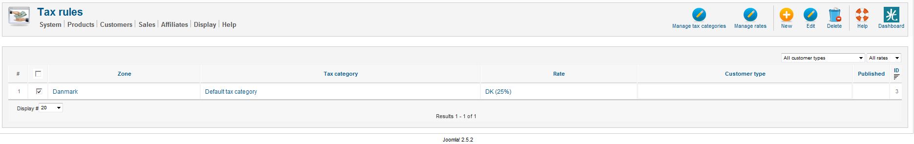

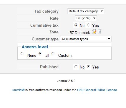

See attached. When I look in the Denmark zone I see nothing that allows me to set the zone as a non taxed zone. Denmark is definitely a taxed zone.
See my tax rule.

Then it means that your tax entries are not configured properly. Please post a screenshot of your tax entries (menu System->Taxation).

12 years 11 months ago #43032
Your tax rule was unpublished. I just published it and it seems to work. By the way, I can see the icon on your back end, so it must be a problem with your browser.
