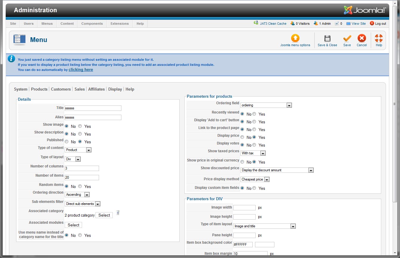

Here is the problem.
If I try to add new menu item with hikashop products listing type
I get this message:
But I don't added category listing! I have added only product listing! If I try to click on that link I will get my products twice per page!
this is bug
HS 1.5.7, joomla 2.5.1

The problem is that I have this message:
You just saved a category listing menu without setting an associated module for it.
If you want to display a product listing below the category listing, you need to add an associated product listing module.
You can do so automatically by clicking here
why it appear in this case? This most confusing

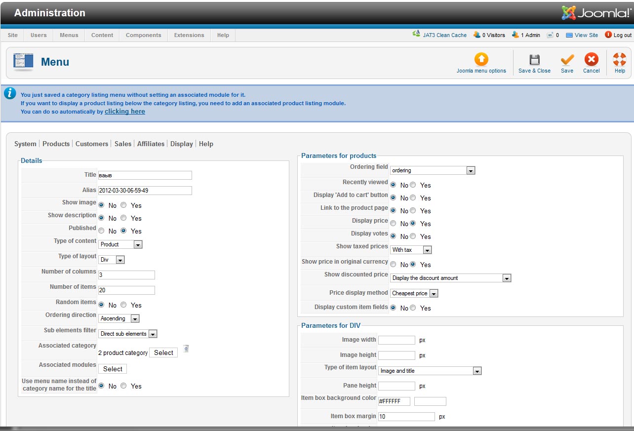

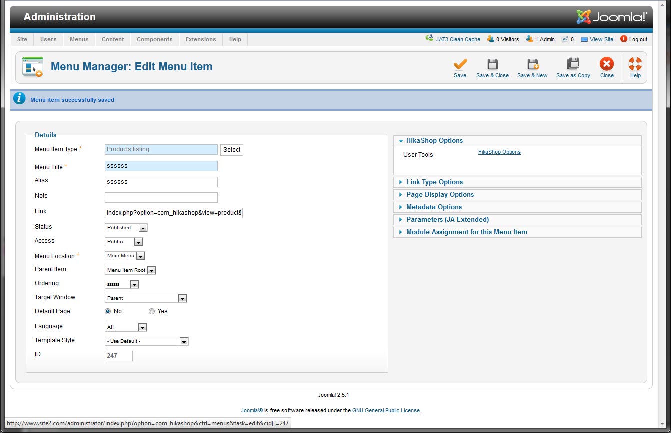

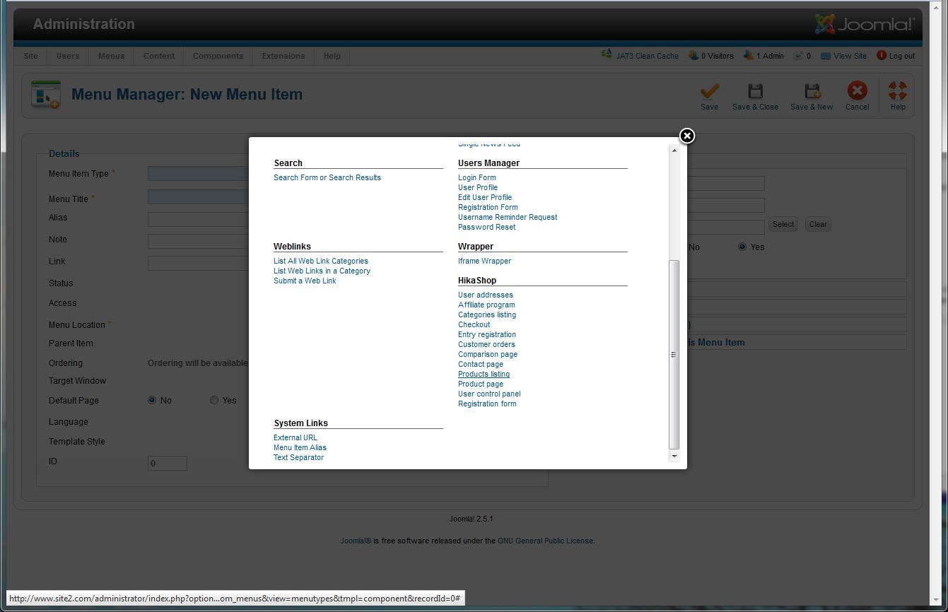

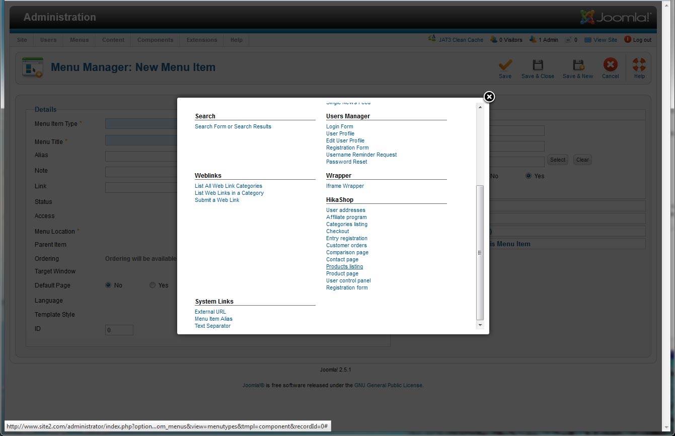

12 years 10 months ago #45413
I have done so as you say
1. create new menu item
2. choose "products listing"
3. save it
4. choose hikashop settings
5. and get error message
here is screenshots
