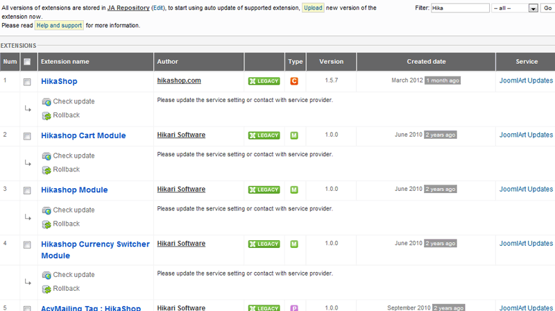

Hi there. We're using the latest version of HikaShop, on a Joomla 2.5.3 installation, and we're using a Joomlart 2+ template with its JA extension manager. This insists on reporting that HikaShop component and all associated plug ins and modules are legacy and it won't cooperate with them. Clearly it isn't a legacy component, but we can't find why Joomlart would think it is.
Is this something that needs to be addressed at HikaShop level or Joomlart level, because we're stuck with the template for now and are happy using HikaShop?

We've never heard of such thing. HikaShop is definitely not "legacy". Could you do a screenshot of the error ?
Did you ask for more information to joomlart ?
Maybe it's a check in their template which is not done properly.

Joomlart's response, for reference. Is it relevant?
joomlart support forum.
Quoth they
"Hi,
This is more of HikaShop and the way they have marked up their software, probably what they have done is that they have only one package for Joomla 1.5.x and J2.5.x "
Anyway. Thank you again.
  • Posts: 83378
  • Thank you received: 13486
12 years 11 months ago #45911
Indeed, our install package is compatible with all the versions of Joomla out there.
So it means that they rely on the xml file in order to guess the compatibility. Which cannot be accurate 100% since xmls which are compatible with all the versions of joomla cannot be distinguished from xmls of extensions comptible with joomla 1.5 only.
So in short: there is no solution.
The following user(s) said Thank You: alloneplanet
  • Posts: 4
12 years 11 months ago #45927
Thanks for your speedy reply Nicolas. It seems like a narrow approach, (which seriously misinforms) by Joomlart. I shall pass it on if you'd like?
  • Posts: 83378
12 years 11 months ago #45932
I'm sure that they could improve their algorithm so that if the form xml elements are used in the xml, they could consider the extension as compatible with at least 1.6 (when it was introduced).
But other than that, they won't be able to determine accurately whether the extension can really run on 2.5 by just looking at the xml with the package is compatible with all the versions of joomla. And I don't see what they could do for that.
