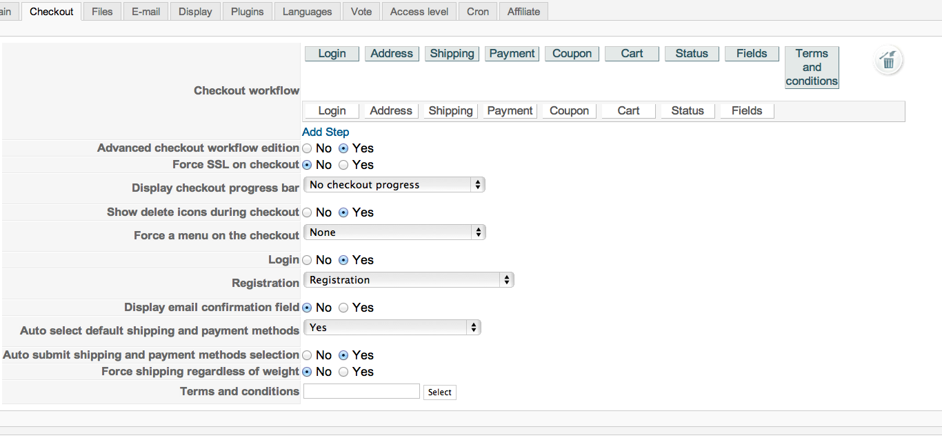

I am trying to change some settings in the Configuration ->Checkout screen but after saving they still are the same.
Any ideas?

I think that it comes from the suhosin module of PHP that is installed of your server.
Please ask your hosting company to increase the suhosin.post.max_varsoption to 500 and it should then work.
I did that, the web hosting company applied the change and hey presto
IT WORKS NOW.
