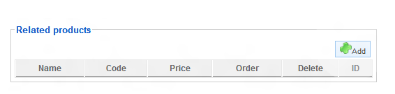

Hi all,
When im in a product and go to press on any of the add button's no popup shows.
could someone possibly help me.
thanks,
Anthony
