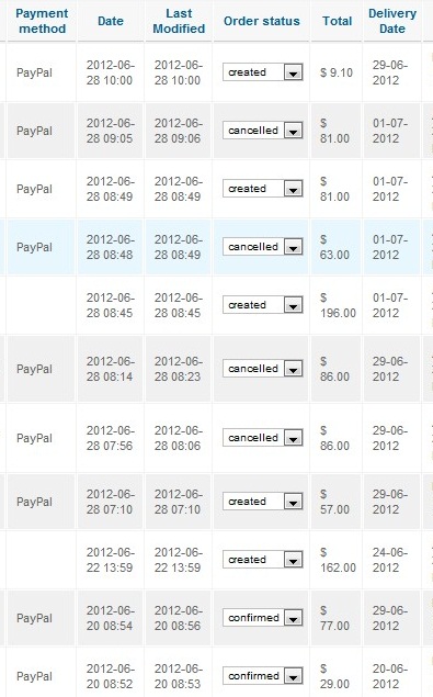

Could you do a screenshot of the history area of the order ?
  • Posts: 27
12 years 9 months ago #55973
I attached to you the screenshot. The one with status "confirmed" are from the sandbox account. Is there any possibility that it might be because of the merchant account ?
