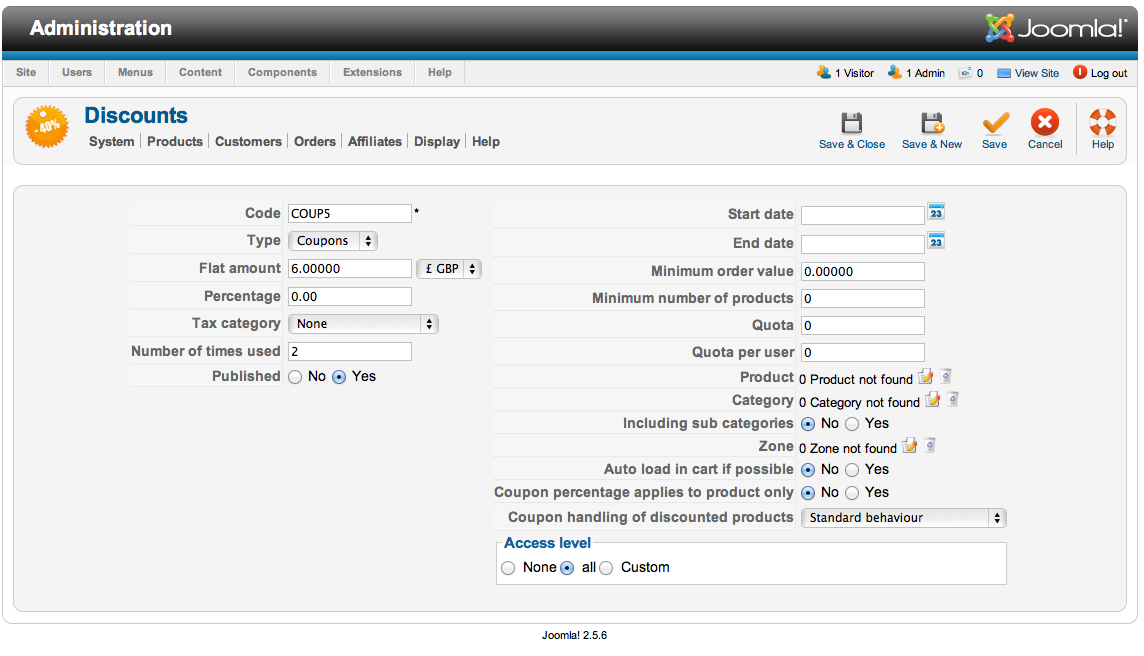

Could you do a screenshot of the coupon's options and tell us the value of the "apply discounts" option of the main tab of the configuration ? That would help us reproduce the problem.
  • Posts: 180
  • Thank you received: 13
12 years 5 months ago #60054
The setting for Apply Discounts in configuration is "After taxes".

12 years 5 months ago #60155
I think that it's working properly, because for example you can :
- Add a tax to your coupon
- Go to "Hikashop->System->Configuration->main"
- Set the "Apply discounts" option to Before taxes
Then your order_discount_tax field will be corectly set.

12 years 5 months ago #60254
Done already (if you mean selecting the Tax category)
Why? That does nor make sense to me. You want the calculation after tax is applied to the products, but you want to see what was taken off the product price and what was reduced on the VAT.
  • Posts: 83179
  • Thank you received: 13433
12 years 5 months ago #60352
The option works the other way around.
When the coupon is applied before the taxes, the coupon is added to the product before taxes have been applied.
Then, taxes are applied to the products AND to the coupon.
If the coupon is applied after the taxes, the coupon value won't be taxed as the taxes calculations have already been done.
