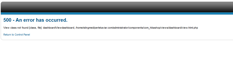

12 years 8 months ago #60820
I upgradede to the last business version last night, and I now get an error when I enter the Hikashop menu backend. This message displays;
500 - An error has occurred.
View class not found [class, file]: dashboardViewdashboard, /home/stingmed/perlekaviar.com/administrator/components/com_hikashop/views/dashboard/view.html.php
If I enter the shop through the submenuitems, it works. But I also get the same problems when I change something, and save it.
Anyone knows what to do?
  • Posts: 26226
  • Thank you received: 4035
12 years 8 months ago #60847
PHP is not case sensitive, but can you try to modify the view.html.php file and change the case of the classname ?

  • Posts: 83674
  • Thank you received: 13545
12 years 8 months ago #60859
For the first error, please download again HikaShop on our website and install it again. That should fix the problem automatically.

  • Posts: 10
12 years 8 months ago #60865
Hey Nicolas, I downloaded the last version, dated today (16.), but the error still shows.
gryttn
  • Posts: 26226
12 years 8 months ago #60878
Hi gryttn,
There is an encoding problem with the view.html.php of the dashboard file.
At the beginning of the file there is some "NUL" characters which are not display in some text editors.
We are currently checking all other files in order to see if another file as been impacted too. We would upload a new package in 3 hours.
Hi watashi,
The Cart/Wishlist feature is just include in commercial version of HikaShop.
I saw that you use the starter version so, there is some links which should not be displayed.
That's why you follow a link which point to a non existing view.

  • Posts: 10
12 years 8 months ago #60893
Ok, thank you!!
Will you let me know when? I tried to download now (about 4,5 hours later), but the problem is still there.
Stian
  • Posts: 83674
12 years 8 months ago #60894
We just uploaded them.

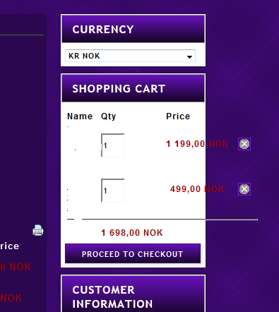

  • Posts: 10
12 years 8 months ago #60896
Perfect! Thanks for your help! Now the errormessage is gone, and the backend works fine!
But I still have problems with my last post: www.hikashop.com/en/forum/4-how-to/60822...rt-and-checkout.html
I'm trying to change the size of the product qty field, but it just doesn't work. Below is a copypaste from the css. Does this seem right?
.hikashop_product_quantity_field{
width: 15px;
Kind regards
  • Posts: 83674
12 years 8 months ago #60898
It probably comes from your template's CSS which overrides your CSS.
You should try like that:
width: 15px !important;
Also, make sure that you clean your browser cache and that you don't have any CSS cache activated on your website.
  • Posts: 10
12 years 8 months ago #60905
Thank you again!
Please bare with me, I soon have my shop set up perfectly!
The qty field is now the way I want it, BUT the price in the cart, is still outside of the cart, see picture.
I thought the price would "jump" back in to the box, when the qty field got smaller...
  • Posts: 83674
12 years 8 months ago #60916
Please download again the install package from our website and update it on your and it should fix that.
