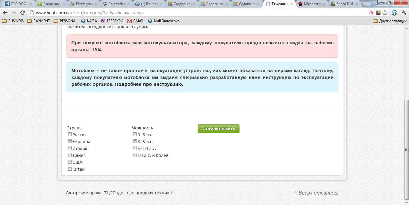

When I check one of customfield filters, the same row from another customfield filter is also checked.
It is difficult to explain it, therefore I have made a video of the behaviour:
www.youtube.com/watch?v=hjDoklAndOM&feature=plcp
Is it a bug, or I configured filters incorrectly?

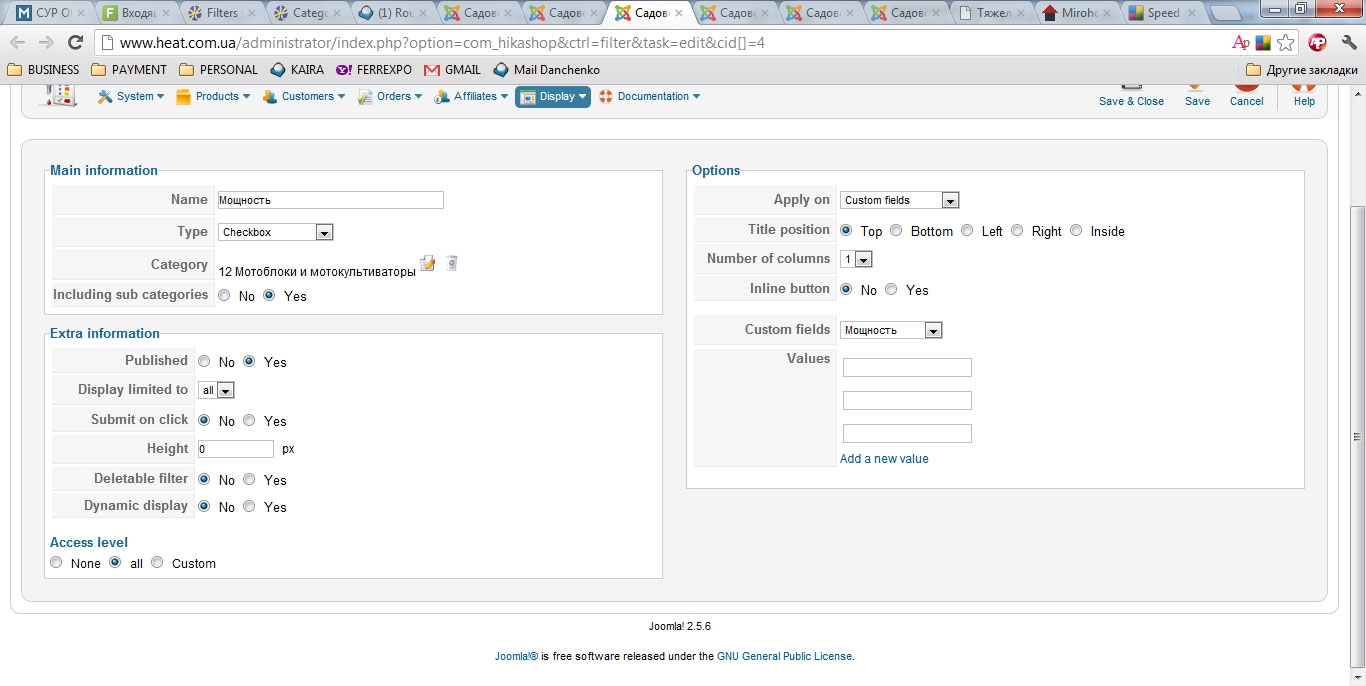

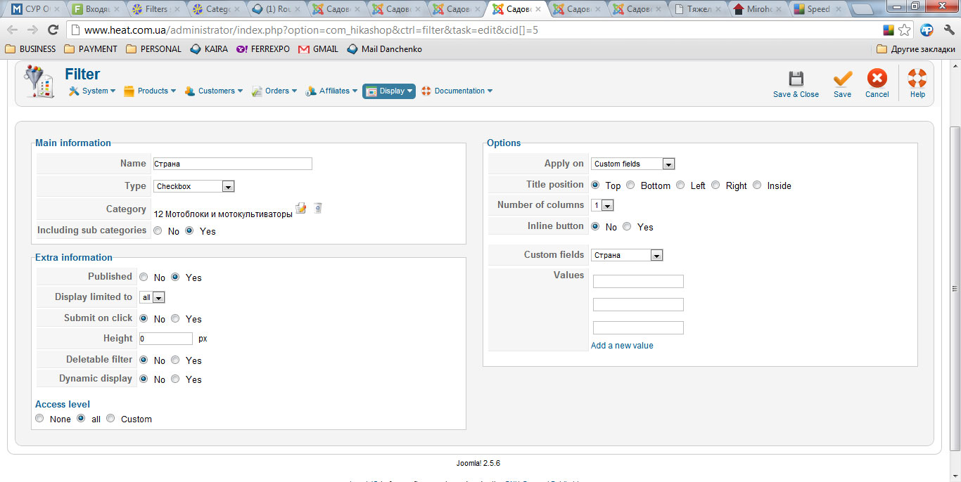

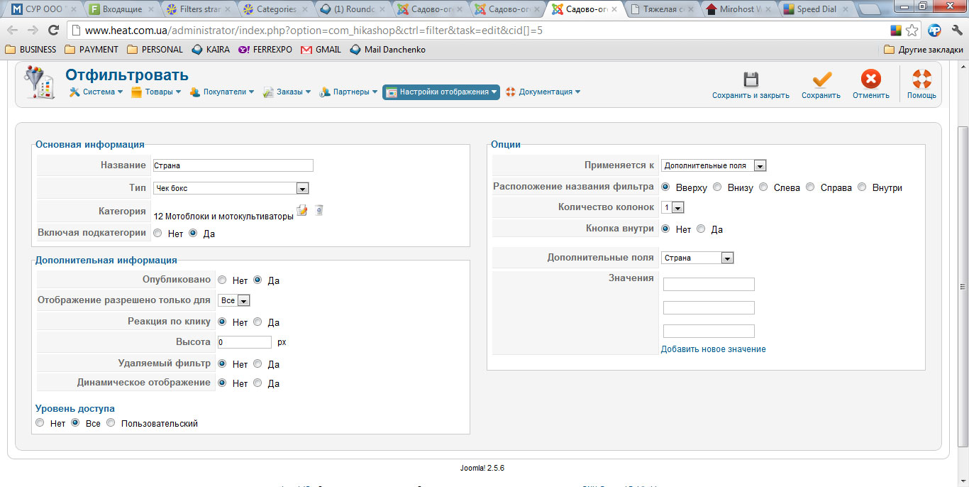

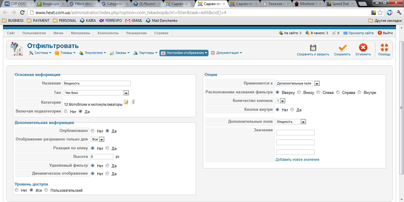

  • Posts: 120
12 years 5 months ago #61264
Please see attached screenshots.
Backend, Filter 1 settings:
Backend, Filter 2 settings:
Frontend, the issue:
  • Posts: 120
12 years 5 months ago #61265
Oops... Sorry for Russian backend. Here are revised screenshots.. :blink:
Filter 1, Backend:
Filter 2, Backend:

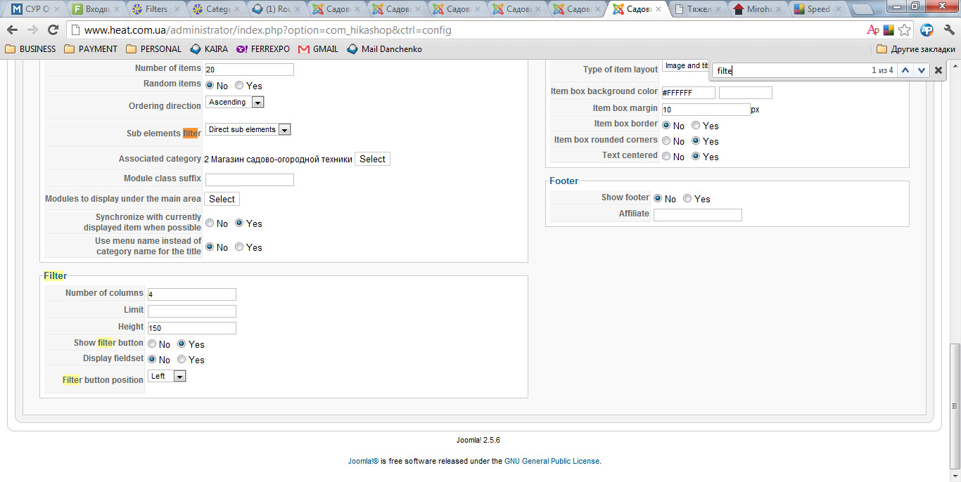

  • Posts: 120
12 years 5 months ago #61266
One more screenshot that I suppose may be useful.

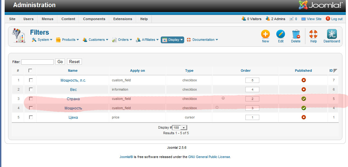

  • Posts: 120
12 years 5 months ago #61401
Hi Eliot,
Screenshot of my custom filters is attached hereto. I have marked the affected custom fields.
Details of these custom fields you can find in above screenshots.
I will also PM backend access to you.

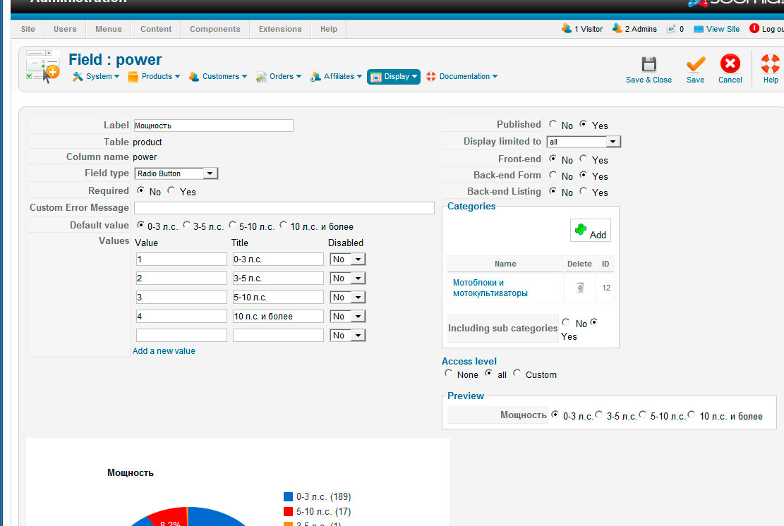

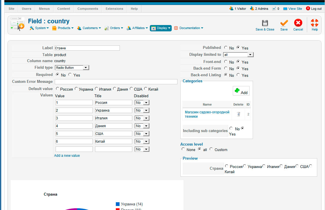

  • Posts: 120
12 years 5 months ago #61404
Oh, I understand. You want to see Custom Fields (not custom filters). Here they are:
  • Posts: 120
12 years 5 months ago #61907
The issue was with cyrillic fonts. Eliot has fixed it for my installation of HS and it will be fixed within next release of HS.
