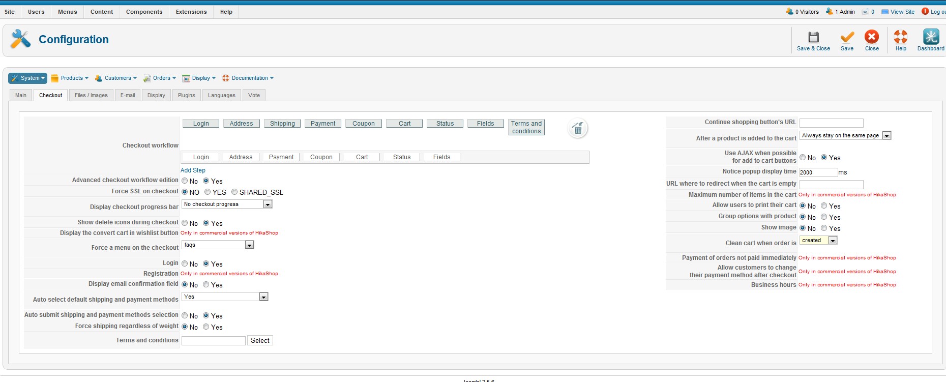

12 years 7 months ago #62751
Hi jeremynsl,
Can you give me a screenshot of your checkout configuration ?
  • Posts: 121
  • Thank you received: 7
12 years 7 months ago #62894
Sure. Its attached.
12 years 7 months ago #62948
Hi jeremynsl,
I tried your configuration on my end, and it's working fine.
Can I ask you to install again the last HikaShop version from our website. The last package has been uploaded this morning.
