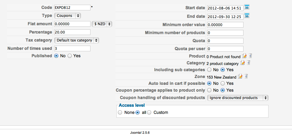

12 years 4 months ago #64975
Here is the product I gave you info about:
www.stacecosmetics.com/hika-cart/product/cid-108
A screenshot is attached.
The Coupon is: EXPO812

12 years 4 months ago #65014
Another question: what did you set in the main configuration about the application of discount ("Apply discounts" option)? After or before taxes?
Also, does all your variants have the same price?
Here are some things to try:
-Do not specify a tax category for your discount
-Try to change the "coupon handling of discounted products" option
We'll try to reproduce the problem on our test sites
Last edit: 12 years 4 months ago by Eliot.

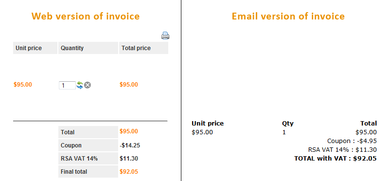

  • Posts: 21
11 years 11 months ago #88670
Hi guys
I'm using Joomla 1.5.23 & Hikashop 1.5.8 Business.
All works perfectly except for the incorrect coupon amount displayed in the email. I've read through several threads on this topic and tried different suggested settings, but unfortunately found no possible solution except for upgrading to Hikashop 1.6.0. However, the development and customisation has taken several months and the product has to be launched ASAP, so losing all customisation is not an option at this point.
Please let me know if there's any way to fix this on the current version I'm running and if you need any login details for the site.
11 years 11 months ago #88799
I don't have the oldest HikaShop version on my computer, so I can't see what changes have been made.
Since the 1.5.8, we released the 1.6.0 and 2.0.0 and now 2.1.0
What I suggest is to install the newest on a new test website and try to compare the content of the email, and see where the coupon data is taken.
  • Posts: 21
11 years 11 months ago #90238
Thank you for your prompt response. Launched without the coupon, but I upgraded today and the discount issue has been resolved.
Time to create page: 0.119 seconds
