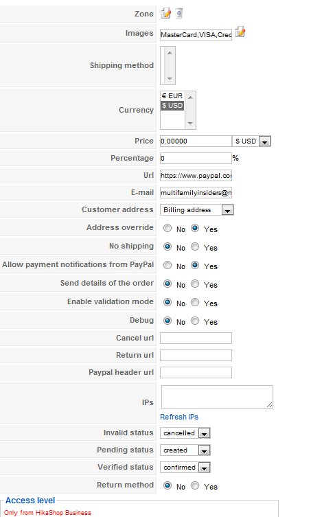

Can you show me how did you configured you Paypal method with a screenshot ?
  • Posts: 78
  • Thank you received: 5
12 years 5 months ago #66423
Sure, thanks! (By the way, I have tested with the "Return Method" both off and on.)

Please try to deactivate Admin Tools and see if that helps for new orders.
If so, then you might have missed something in the configuration of Admin Tools.
If that still doesn't solve the problem, you should activate the debug mode of the payment plugin, do a purchase and look at the payment log of the Files tab of the configuration. That will give traces of what's going on with the notifications.
