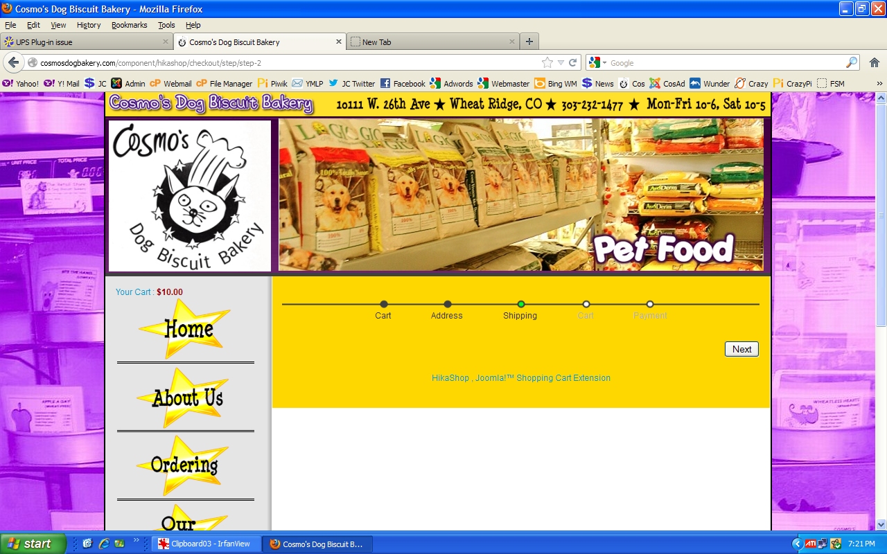

I had previously reported an issue with the UPS plugin causing a PHP memory overload error. I've found that I can get around that by making the shipping a separate step instead of having all the checkout steps on one page (my host will not increase that limit). However, I now have the issue that nothing at all shows up on the shipping page when I select the UPS plug-in, just a 'Next' button. Let me start with this question- are the UPS access key, USER ID, password, and Shipper Number all required to get the plug-in to work? I'm building this site for a client, so perhaps they have that information, but I wanted to test the ordering process in the meantime. If they are required, that is the problem. If not, any suggestions?

UPDATE Suddenly the same problem is happening on the address step- before, an ajax popup would allow me to enter an address, but now this screen is also blank with just a Next button

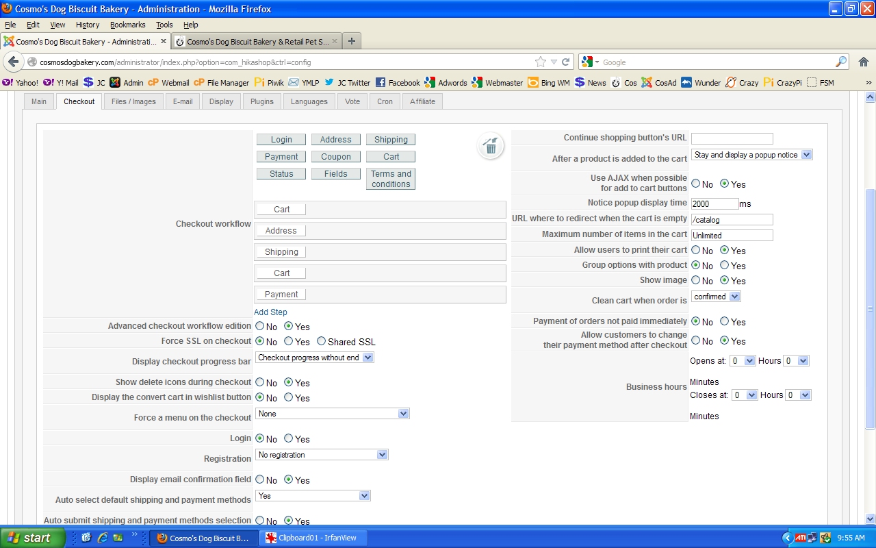

Could you post a screenshot of your checkout configuration ?

14 years 6 days ago #70563 by rockstarnomad
Replied by rockstarnomad on topic Re: UPS Plug-in issue
Here you are.

14 years 6 days ago #70566 by Xavier
Replied by Xavier on topic Re: UPS Plug-in issue
That's because the login step must be present in the checkout when the address is here, I recommend you to put the login at the same step than the address.
And for the option, "Registration" set it to "no registration"

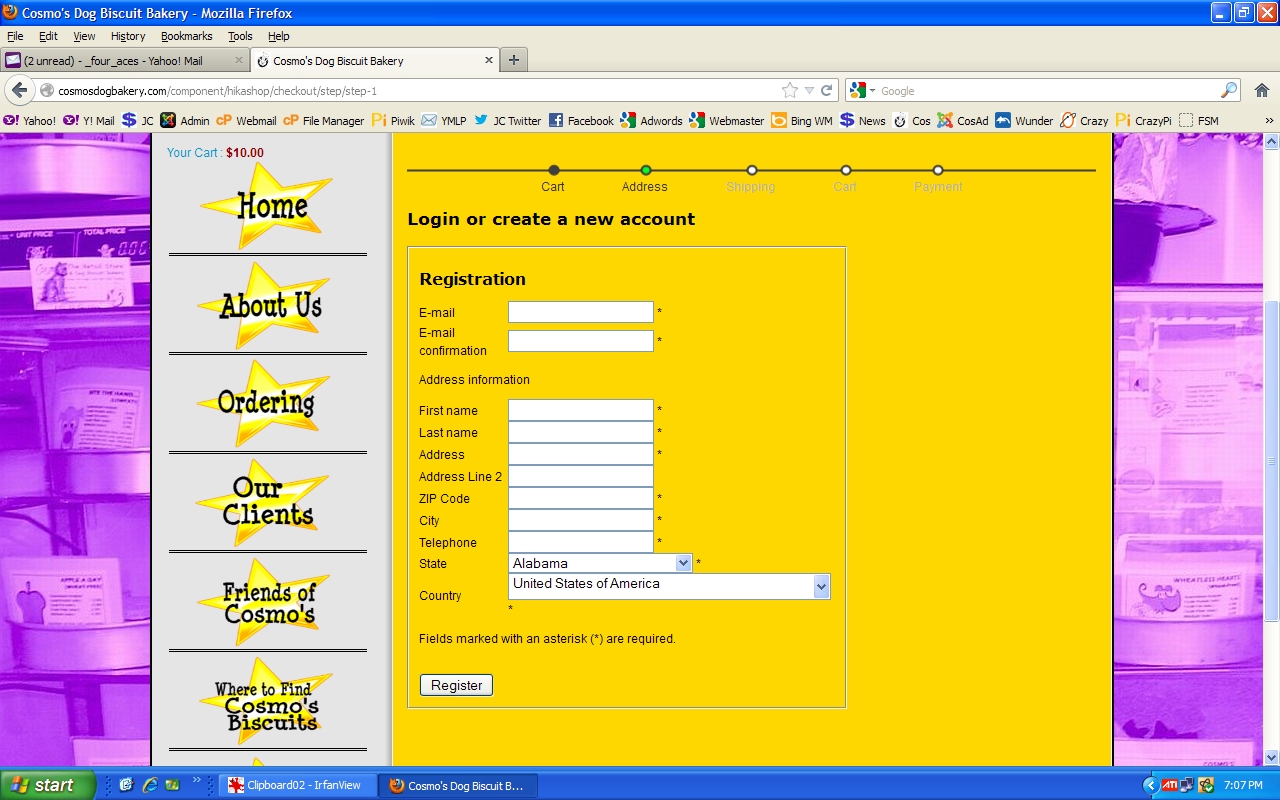

At one point, when a user came to the address screen, it would be an AJAX-looking white pop-up box where they would fill in their address. There was another box afterward that said 'use same address for billing' that could be checked or un-checked. This is what I want to have. Currently, the 'Address' step is a registration box- I don't want users to be registering, and I want the billing/shipping box to return. Here is a screenshot of the current page that I see. How can I go back to the address pop-up and billing/shipping and not have the registration form?

14 years 5 days ago #70620 by nicolas
Replied by nicolas on topic Re: UPS Plug-in issue
That's not a registration form.
That's an address form.
The text says that you can can just change the text with translation overrides:

14 years 5 days ago #70622 by rockstarnomad
OK, I've done some overrides already so that's no problem. However, the shipping screen on the next step is still blank except for the next button.
