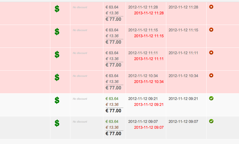

When people use a coupon code with 100% discount, the level gets set in ASUBS but the subscription not activated.
To be precise: the status is set to COMPLETE but not activated

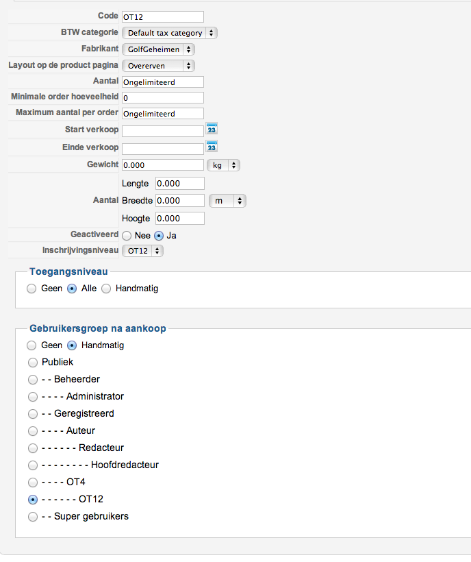

Can you give us screenshots of your configurations ?

Normal purchases go through without problem but with the coupon code it just not only gets not activated, for some reason I can not even set them activated manually afterwards.
Also the discount is not passed on to ASUBS and therefor showing an amount that was never paid.
article setting:
Result in ASUBS:
All of these ordered the same item, the red ones with coupon code of 100% (= free)
It is not very urgent I have an overload of work at the moment so if there are more details needed I might need a little bit more time....
Bastiaan

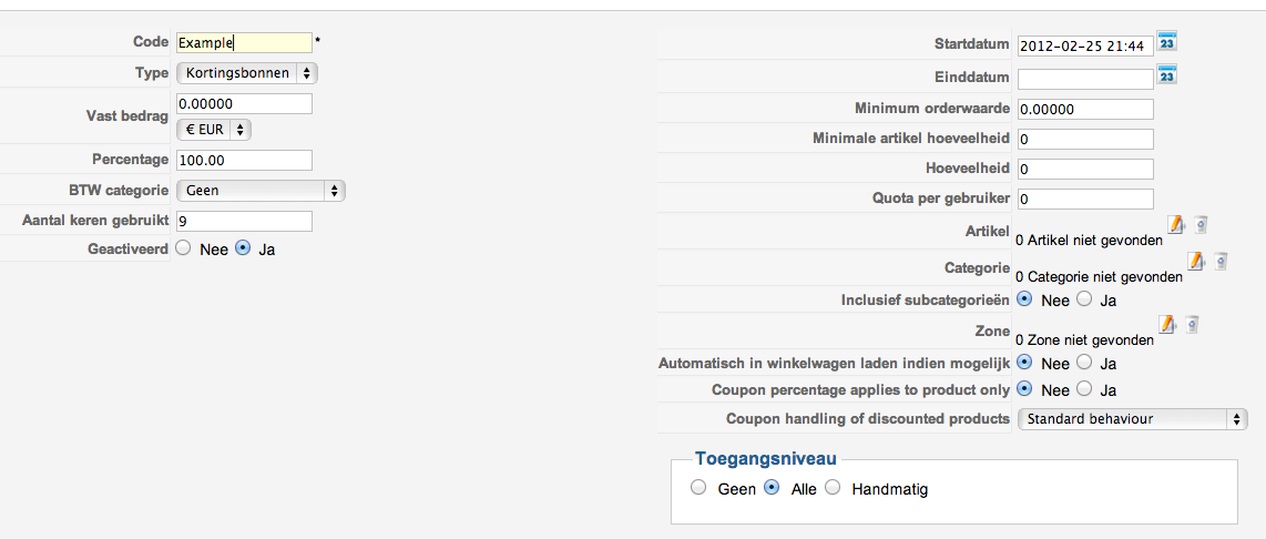

Can you give me a screenshot of your coupon configuration ? So I can reproduce the problem on my end.
And when I was asking you which version you have, I was talking about the Joomla - HikaShop versions ;)
