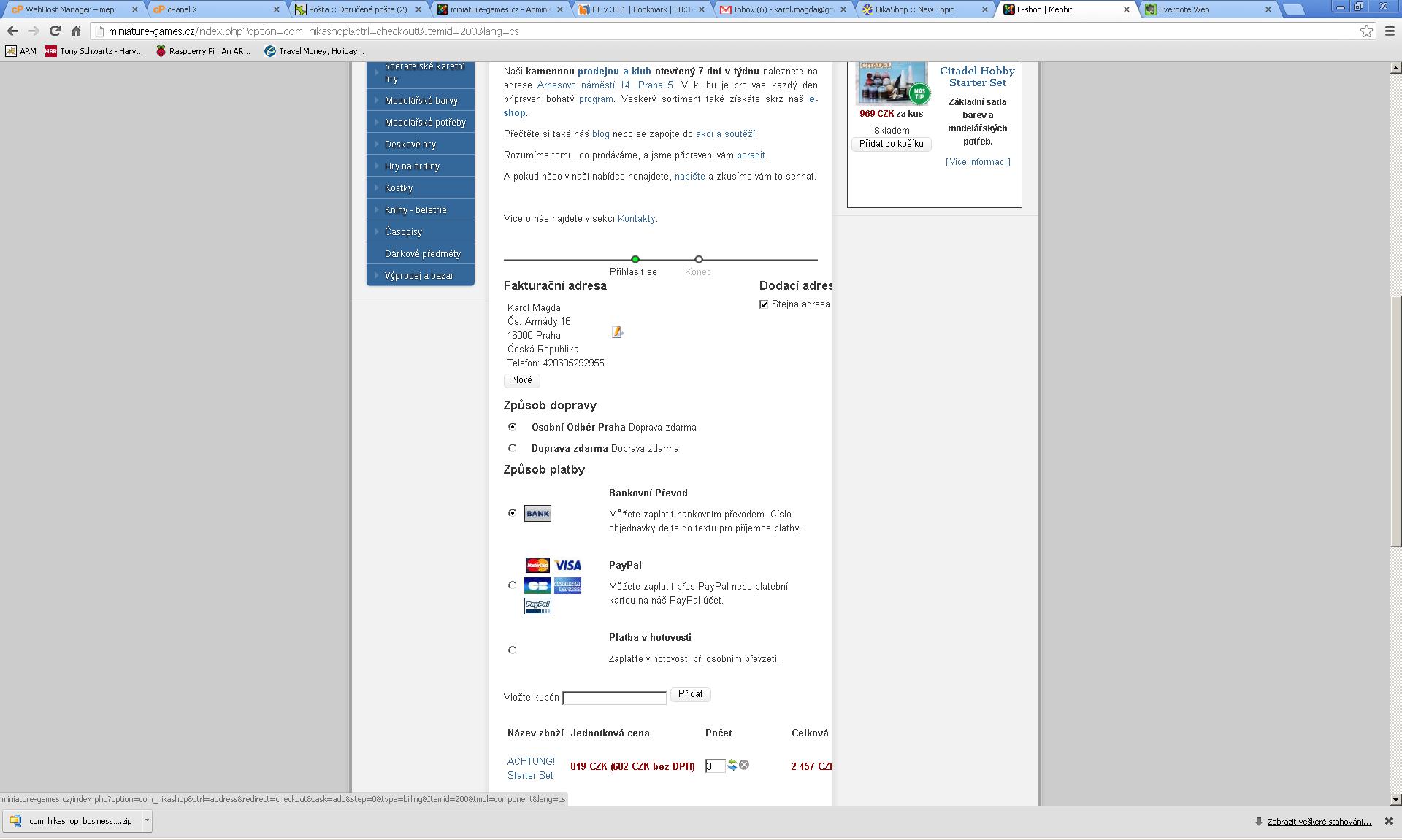

I am having problem with v2.0 Hikashop. Whenever I try to go to cart from front page I am not redirected to checkout page but checkout page is displayed below the content displayed on the front page. The functionality works well for me in v1.6 Hikashop.
See also added screenshot.

That is not related to the 2.0.
You need to configure the "force a menu on checkout" option of the Checkout tab of the configuration so that the checkout won't display on the home page.

We didn't change anything on that end and no one reported such issue nor are we able to reproduce such problem on either 1.6 or 2.0.
That is a potentially normal issue when that option is not set, like you have on your websites, based on how you configure your menus/modules.
As I said, you just need to set that option and that will work like you want.

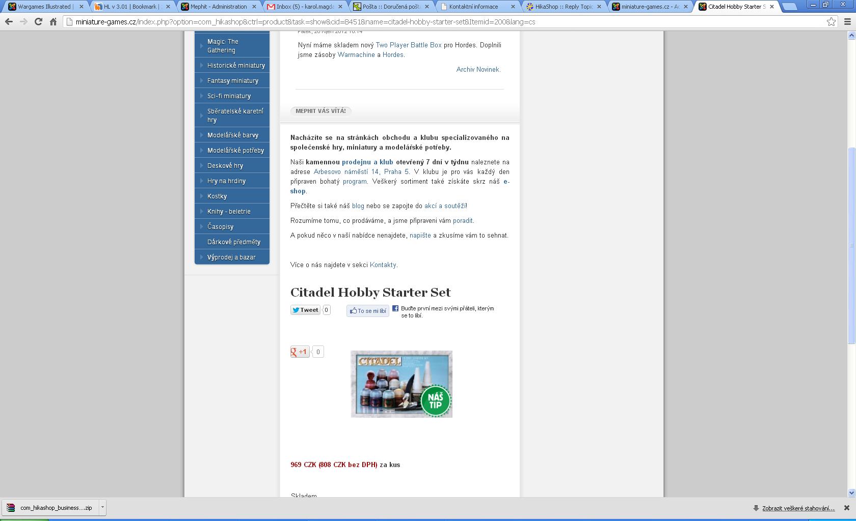

Ok, I sorted that out with what you've suggested. I have similar problem when I display product detail information from front page - instead of new page loading the information is displayed down below. See screeshot.

12 years 3 months ago #78089
I think that you can solve this problem by going in the Joomla menu parameter for your product listing, then in the assigned modules, remove the modules displaying the content at the top.
Or edit the module options and remove the menu assigned from where this product page is displayed.

For your problem regarding the products being displayed on the frontpage, that's the solution that Xavier told you that you need to do.
Here is more precisely what you need to do:
Edit the module with the id 119 via the menu Display->Content modules and select the menu with the id 59.
