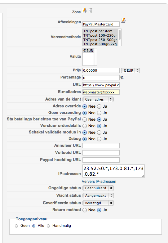

Hikashop 2.0 and J 2.5..8:
When some one uses the PayPal plugin, the order gets through all the way to PayPal, inc. the confirmation from PayPal but the the client is not set to confirmed on the site.
Here are out settings:
