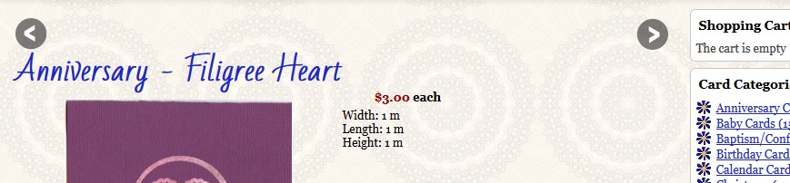

I have enabled the "Show shortcuts to other category products"
The prev/next buttons are displaying fine.
There are two problems:
1. The button on the right side ain't working, you can't click on it.
The button on the left side works. How can I fix it ?
2. When I click on the button to the left (the one that works) it does not take me to the previos product, it looks like it takes me to a random picked product.
How can I fix this ?

1. That's because the right product part div is hover the button, so you can't click on it. Try to set these properties in the css file:
2. These buttons are here to navigate between products in the same category, I think that your products are in many categories, that's why the products related seem's to be random picked.

Hi!
Tnx for reply
I fixed the CSS problem, so that's OK.
Yes that is correct that my product are in different categories.
Is there anyway we can get the navigation next/prev only to switch products within the given category ?
