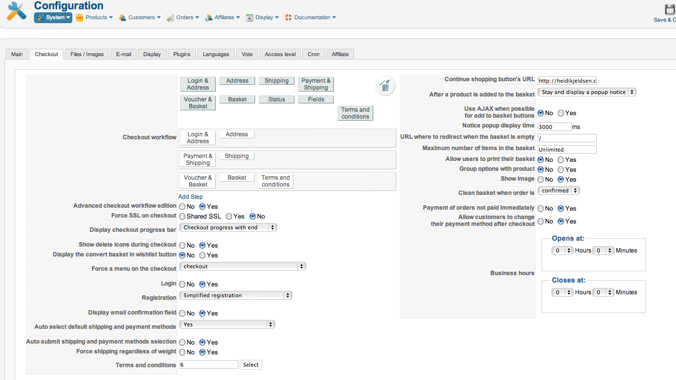

@PhantomPWR And could you provide a screenshot of the Checkout tab of the HikaShop configuration on your website please ?
  • Posts: 79
12 years 3 months ago #80036
I've attached my checkout configuration.
I don't know if it's relevant, but I've also modified the checkout->step view to change the 'next' button to 'confirm order' in the final step.
The unusual names in the workflow is because I've added language overrides for the progress bar to display properly.

Did you do any other overrides in the checkout view files ? If so, please remove all of them and try again.
Your settings are fine and there is no such problem with the latest version of Hikashop so it must come from a view file of a previous version of HikaShop. That's all I can think of.
